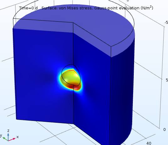

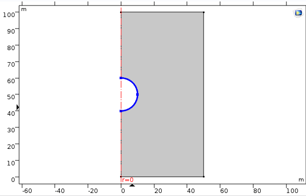

I have a solid that it deforms over time under the action of loads (elastic+creep).
The solid is a cylinder with a hole with sphere geometry (initial) in the center. With the passage of time the geometry of the sphere will change and also its volume. The problem I have is that the sphere is not a mesh domain, so I am not able to calculate its volume with a double integral and including 2pir (by clicking the postprocessing box), or creating an expression like this 2pir. I am able to calculate the surface of the contour but not the volume.
I solve the temporal evolution of the volume by including nonlinear geometry in the solver. And as an "approximation" to solve the problem I have included a material with properties of "air" in the hole. But I am concerned that as I make the model more complex, this jump between the properties of the cylinder and those of the artificial domain "air" that I have created could give me problems. I prefer being able to calculate the volume directly.
Somebody could help me? I've been looking at the Forum for days and there's a lot of information about axisymmetric 2D volumes but nothing works. I think the problem is the fact that I have to calculate the volume of a hole or external boundary.
Attached two pics.

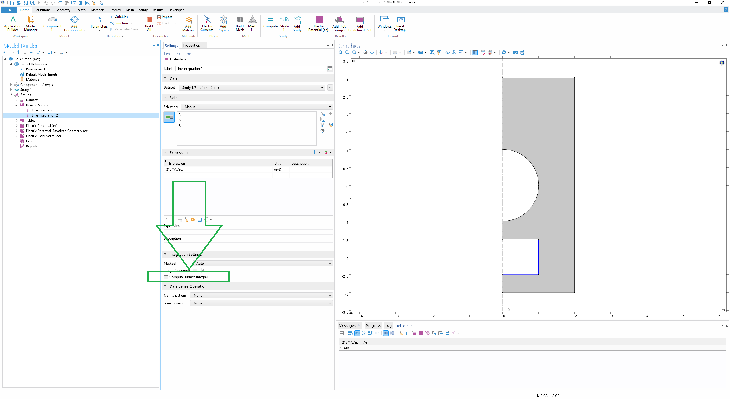

I have applied this method and another variant that is , where dA would be dr*dz (area differential). However, neither of the two methods gives a correct result for a contrast test with a sphere of 10 m radius.
I think the problem is that the COMSOL simple integral operator calculates the line integral, that is: , where dS is the differential arc length of the boundary, but I would need it to do the integral: where dz is the height differential and I don't know how to do this.
Applying: "Results>Derived values>Line integration" on the boundary shaded in blue of the figure "hole_in_volume_2D_axi" with the "Expression (1)" half the length of the circle is obtained. And if I carry out the same operation, in that same contour but applying the "Expression ()" I obtain the surface of the sphere that encloses the volume that I want to calculate. In the case of a sphere, I could deduce the volume from the surface (as long as the deformation is low). But this does not interest me, I only use the sphere as a test to know that I am doing the calculations correctly, I need the volume to be calculated in a generic way for any type of boundary that generates a hole within the axisymmetric 2D model.
If you can help me I would greatly appreciate it.

Hello Andres,
There is, as you suggested in another thread, an elegant solution based on the Divergence Theorem (DT) that does not require meshing the hole,
Here's how.
Start with the DT applied to the hole:
volume integral of div(F) = surface integral of (F.n)
where n is the normal vector pointing away from the hole
The trick is to choose F=z*ez
where ez is the base vector in the z direction.
Then div(F)=1 and the l.h.s. of the DT is the volume you want to compute.
The r.h.s. of the DT, accounting for the axisymmetry, is
line integral of 2*pi*z*r*nz
where nz is the z-direction component of the normal vector pointing away from the hole.
Voila!
This approach is implemented in the attached file. You can see that it checks out on a sphere and cylinder.
