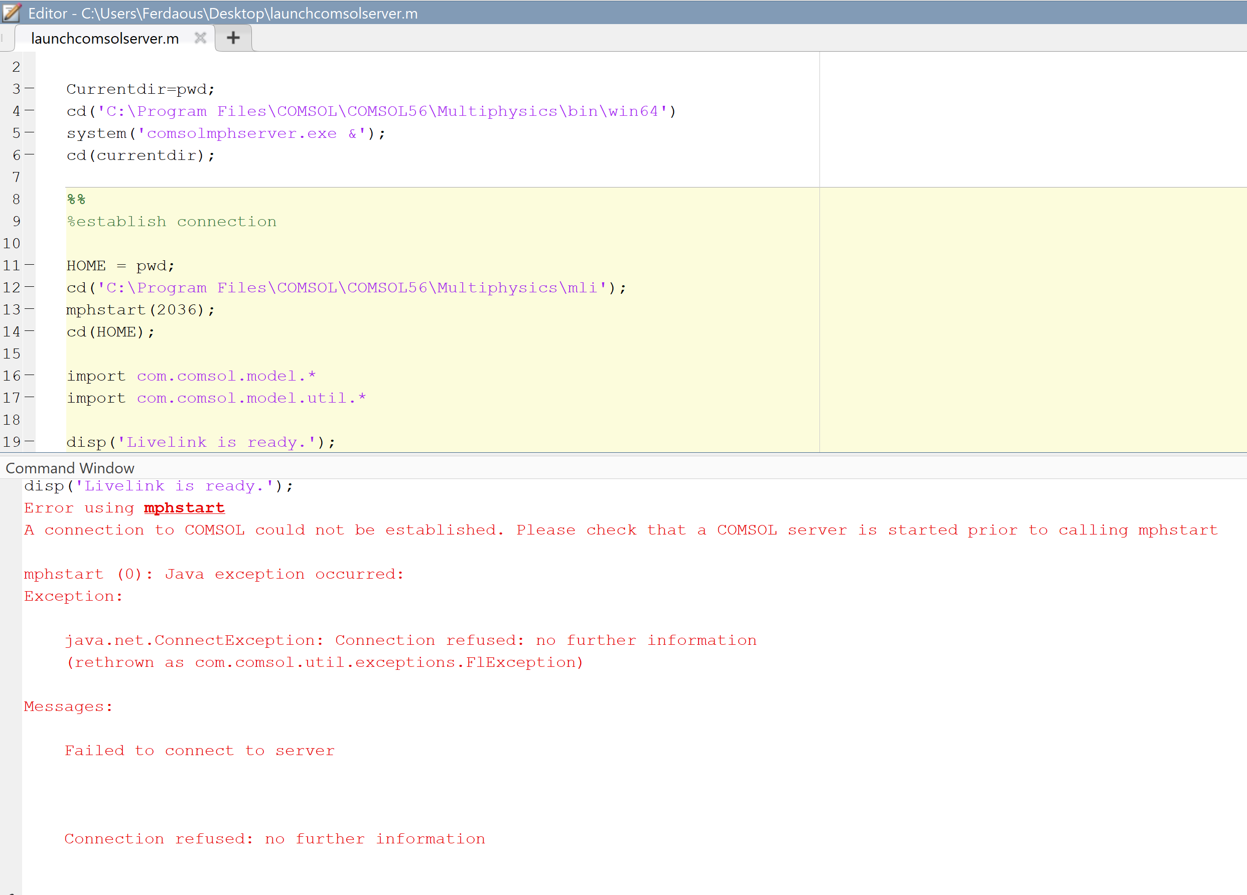

Hi everyone ,

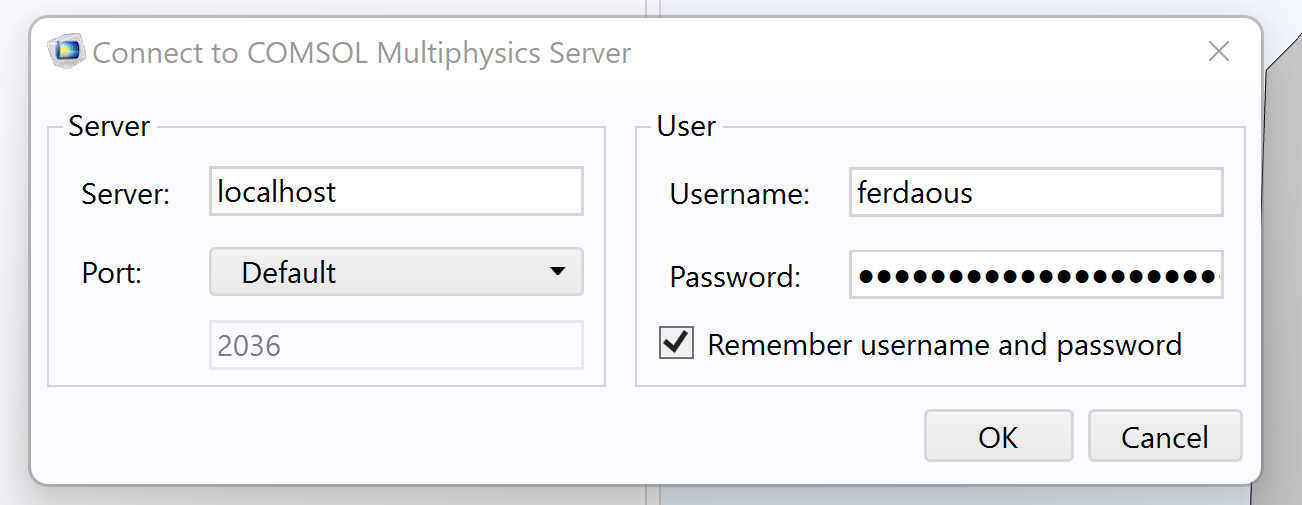

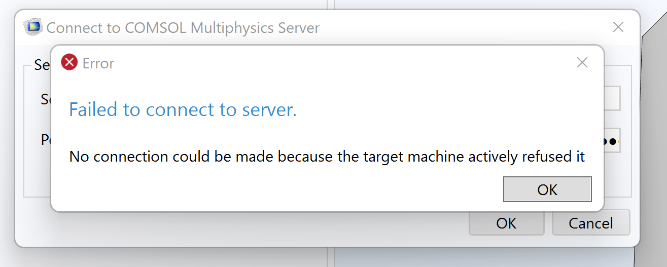

i'm facing a problem with comsol multiphysics 5.6.
I'm trying to connect comsol to server but i get the message below ; No connection could be made because the target machine actively refused it
another problem is that i'm not able to connect matlab with comsol as shown attached :
i'm using comsol 5.6 and matlab 2020 a
thanks in advance;

I would start by checking that the port number is correct.
Secondly check that your firewall isn't blocking the connection.
