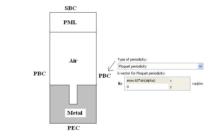

For a metal grating (see attached Structure_Reference.jpg), now I would like to analysis the dispersion relationship of surface plasmon wave supported by a metal grating, which propagates along the surface of the grating.
I choose Eigen-frequency analysis method:
I set left-right boundary as periodic boundary condition with Floquet periodicity (the related setting as well as other boundary conditions see Structure. JPG);

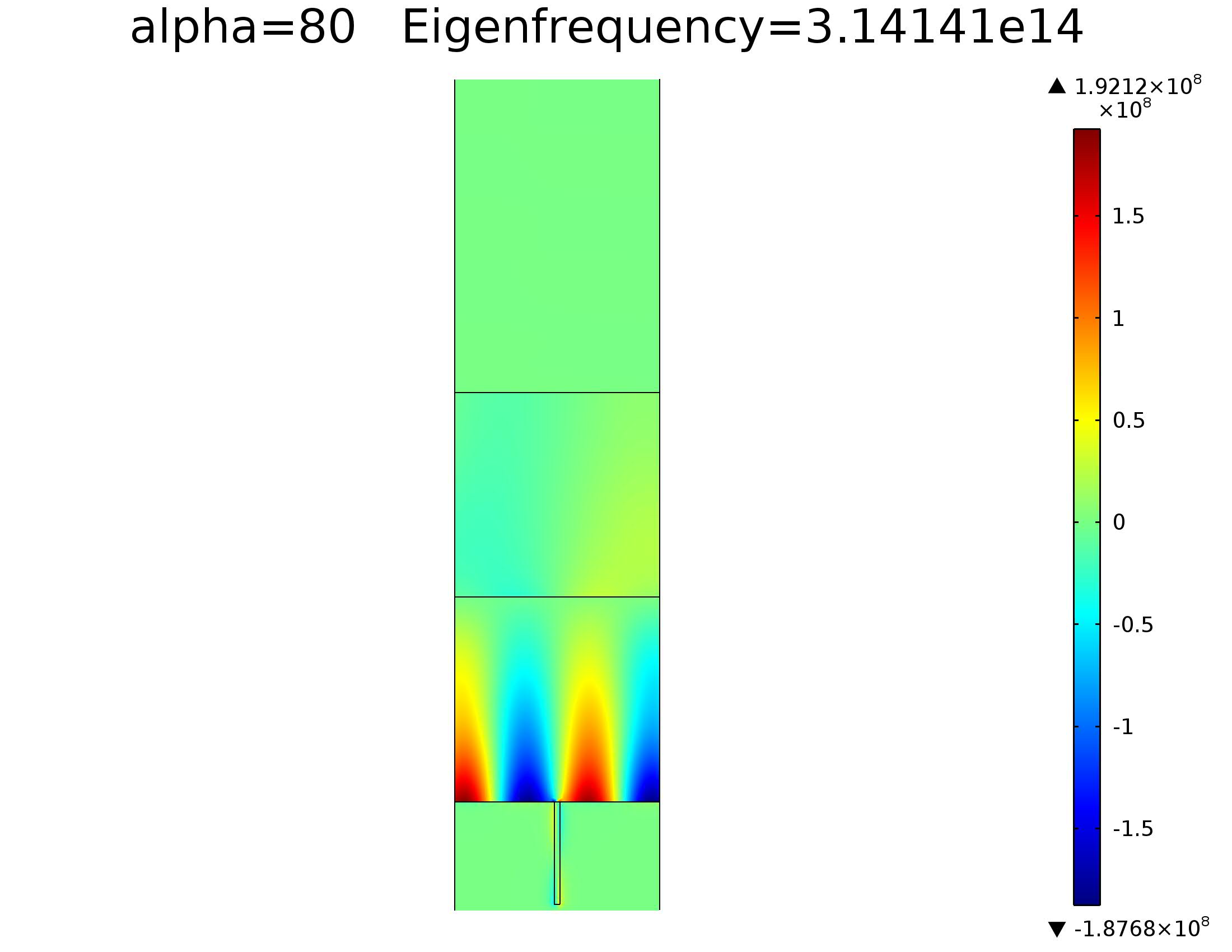

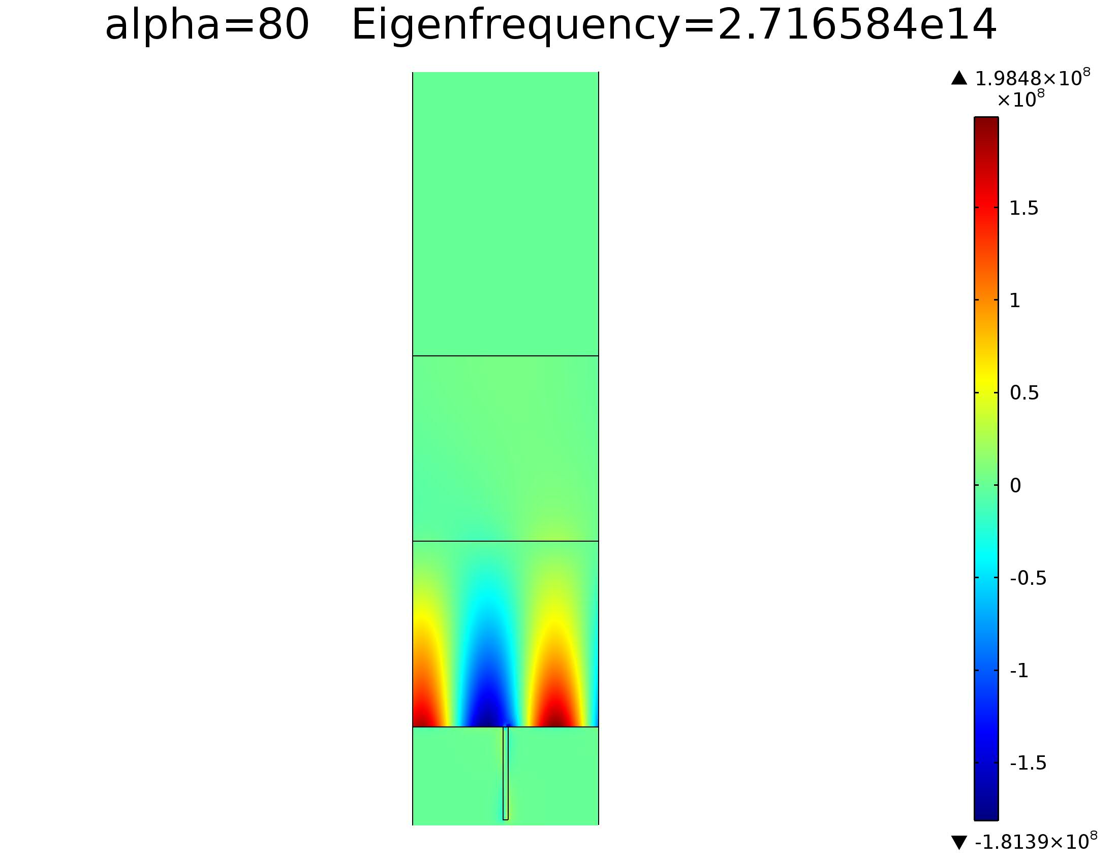

Here giving an example, when alpha is set as 80 degree, then the related eigenfrequency of surface plasmon mode is analyzed, the corresponding field distributions are see attached (a.jpg and b.jpg).
From the distributions, we can see that they are indeed the surface plasmon wave supported by the structure.
Then the dispersion relationship can be obtained simply based on these eigenfrequency values.

I'd include PML on the bottom as well. Other than that, everything seems fine.

Actually, when the dimension of PML changes, the eigenfrequency changes as well, it is unreasonable.

perhaps you PML is not 100% then, reflecting back energy, or it's too close to the grating

Yeah the reason is that PML is close to the structure.
Yet, maybe my thought is not right, the dispersion relationship of surface plasmon wave is wrong.
I am so stuck with this model i.e. how to get the dispersion curve of surface plasmon wave that propagates along the metal grating.

You won't get dispersion curve with eigen solver. You might want to use frequency domain simulations instead.

No, it's different type of study + small changes to the model.
Eigen-solver finds eigen-frequencies of the system which does not depend on excitation.
For frequency domain studies excitation (input wave) is required so boundaries should be changed.

another point that strikes me is that the field response is not periodic, but looks more antiperiodic w.r.t. left-right F boundaries, or have I missed a point ?

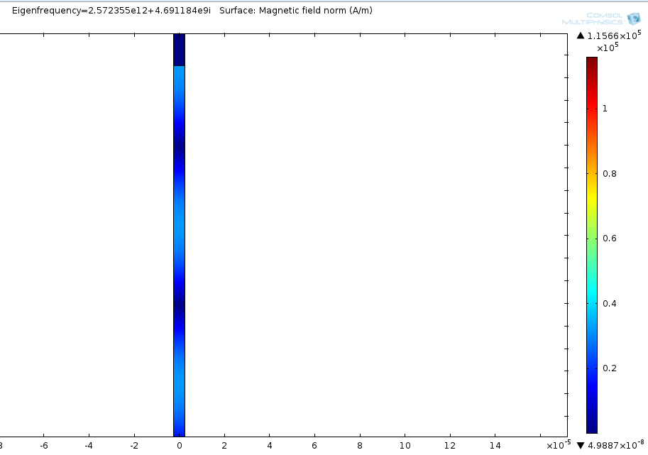

Can you explain in some detail how you set up that PML at the top? I'm performing a very similar simulation with a dielectric waveguide at the bottom rather than the SP waveguide and I can't figure out how to set up the PML. I've attached a screenshot that shows the upper portion of my air domain on top of the unit cell and the PML at the top. The magnetic field of one of the eigenfreq solutions is shown in the attached image. It appears as though the boundary between the PML and the air is just a PEC.
How did you define the boundaries? Is meshing important? Do you generally have to provide any inputs, or do you just add the domain, designate it PML and solve (it seems that's all they do in the tutorials)?

in the last version 4.3a you define the infinite or PML's under the Model Definition node
Ideally the INF region should be meshed with quad/prisms in layers, I would adopt that for MPL's too, but in any case have > 5 elements across
In older versions the INF and PML were defined under the physics, do not forget to define the shape (cartesian spherical cylindrical), and for INF at least define the origin somewhere in the middle of your model, or easier centre your model at (0,0,0)

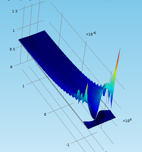

Did you try to smooth the corner of the grating? For example, using a grating of sine shape. I can reproduce your result. But when I use a sine shape grating, the field near the Floquet boundary show much fluctuations. Do you know what's wrong with my model? Thanks
