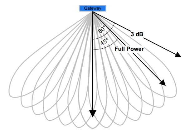

Thank you for your reply. I'm actually trying to recreate a dual linear polarized RFID reader, at UHF frequency as shown in the image below. The radiation pattern is circular so you should be able to see that no matter the angle. I only have RF module on my licence at work, and I cannot install anything else at the moment, but something could be done with it.

sounds like a circular or linear polarized patch antenna is what you want. I think there is an example in the application library.

Indeed! The circularly polarized antenna example of the library suits me very well. I'll let you know if any other issue comes up.
