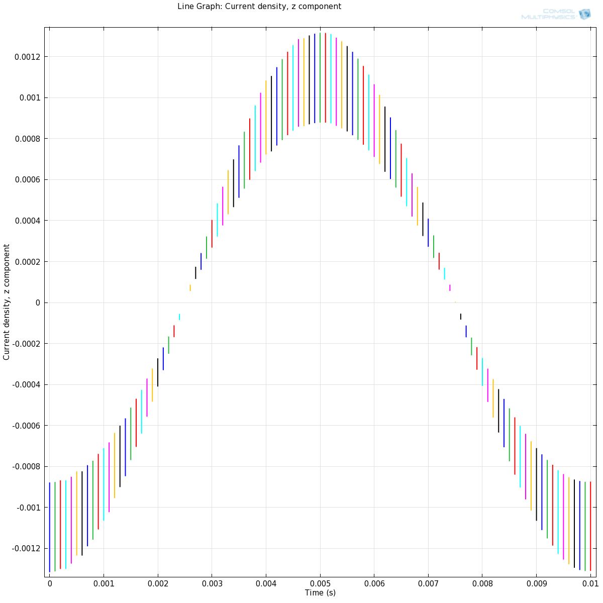

Posted: 1 decade ago 27.07.2012, 10:37 GMT-4
when i insert two different material in the electric field,
the current curve was different from the previous one with single material which one dot represent a current value
become one line as the figure i attached.
but the result when i make the line integration on the gound electrode was one value at one time.
thanks.
Sam
when i insert two different material in the electric field, the current curve was different from the previous one with single material which one dot represent a current value become one line as the figure i attached. but the result when i make the line integration on the gound electrode was one value at one time. thanks. Sam
