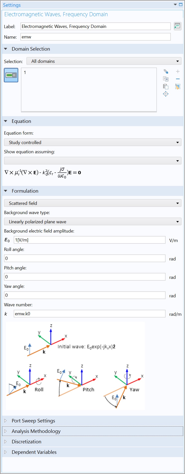

You say "...when it receives a planar EM wave from the air. I'm using port to model the EM wave."
That seems an odd choice to me, because if I were creating a model with an incident plane wave, I would use the scattered-field formalism (see attached image), if practical. Have you considered doing that?
You say "...when it receives a planar EM wave from the air. I'm using port to model the EM wave." That seems an odd choice to me, because if I were creating a model with an incident plane wave, I would use the *scattered-field formalism* (see attached image), if practical. Have you considered doing that?
