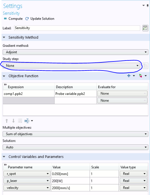

I am trying to perform a sensitivity analysis for a time-dependent heat transfer model. I have a probe set up at a point in the geometry where the temperature is being recorded and I would like to perform a sensitivity analysis for temperature evolution there for control parameters laser power, scan speed and laser spot size(it's a LPBF model). But the sensitivity analysis module is not letting me select 'time-dependent' as the study step. Any suggestions will be much appriciated.
