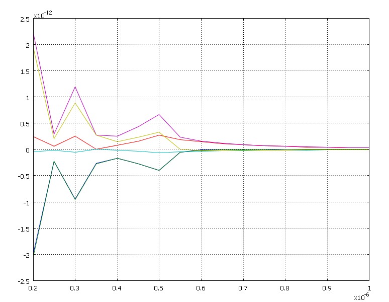

I only got started with COMSOL and was very happy to find the Model 'Mie Scattering off Plasmonic Nanoparticle and Radar Cross-Section Computations'. I followed all the instructions, but when I tried to do the mesh, it wouldn't let me do the swept mesh at first, saying there are involuted elements (even though I followed the instructions to the letter)...
I tried the swept mesh some more and suddenly, it was working fine - until, after 2 hours of calculation time, I saw the results: lots of warnings about an 'inverted mesh element near coordinate (9.24802e-008,9.24802e-008,2.6999e-007)' (these coordinates change slightly when I solve again) and a global variables plot which looks completely unlike the one in the documentation (see attached). What is going on here? I'm at my wit's end...

Play with meshing more.
Define it manually with care, sometimes automatic meshing give you better results (avoiding inverted elements) but could be not enough for nanoscale.
Play with meshing more. Define it manually with care, sometimes automatic meshing give you better results (avoiding inverted elements) but could be not enough for nanoscale.

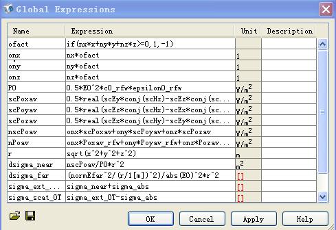

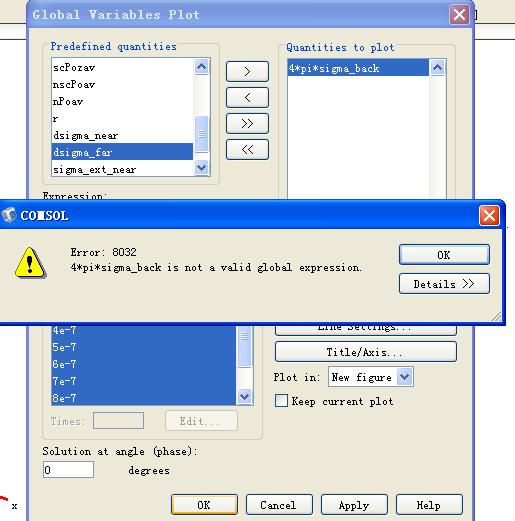

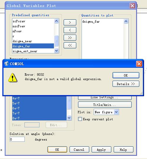

Hi, I am happy to find your example about radar cross section. But I met a problem when I fllowed your example. It happend in Global Expression(dsigma_near, dsigma_far). When I want to plot 4*pi*sigma_back, I met the problem as fllowed: disgma_far is not a valid global experssion. I do not know why.
Posted: 2 decades ago 15.03.2010, 04:54 GMT-4
I believe there is a quick reply for your units issue the "r/1[m]" this gives [m] if "r" is without units, or [m^2] as I expect "r" is in [m] and is different from "r/(1[m])" which is without units or equivalent to understanding it as (r[m])/(1[m])
Will have to look closer for the global expression, but I'm a t a Comsol course just now ;) and Ihave to liten to the speaker too ;)
Have a nice day
Hi I believe there is a quick reply for your units issue the "r/1[m]" this gives [m] if "r" is without units, or [m^2] as I expect "r" is in [m] and is different from "r/(1[m])" which is without units or equivalent to understanding it as (r[m])/(1[m]) Will have to look closer for the global expression, but I'm a t a Comsol course just now ;) and Ihave to liten to the speaker too ;) Have a nice day Ivar

Posted: 2 decades ago 16.04.2010, 07:13 GMT-4
Hi everyone!
I have the same problem with the model; for some wavelengths the scattering cross section becomes negative which makes, of course, nonsense. First I thought it was probably a mistake I made while defining the global expressions or the integration ones, so I repeated the process several times but I obtained the same result over and over. Later I thought that maybe one of the steps in the documentation file was wrong, so I ended downloading the file .mph directly from the model gallery instead of trying to reproduce it myself. Everything was already defined in the file so I just had to mesh the model and solve it. To do so I followed the instructions (mesh size, number of layers in the exterior subdomain, solver parameters,...) exactly as they were written in the documentation. It was a big surprise to find out that I had exactly the same problem as before. I wanted to attach the scattering cross-sections obtained with the downloaded file (Mie_scattering_plasmonic_reset_35a1.mph) to illustrate the problem but the attach button is not responding. Anyway, any idea about what could be wrong?
Thanks a lot,
Ramon
Hi everyone! I have the same problem with the model; for some wavelengths the scattering cross section becomes negative which makes, of course, nonsense. First I thought it was probably a mistake I made while defining the global expressions or the integration ones, so I repeated the process several times but I obtained the same result over and over. Later I thought that maybe one of the steps in the documentation file was wrong, so I ended downloading the file .mph directly from the model gallery instead of trying to reproduce it myself. Everything was already defined in the file so I just had to mesh the model and solve it. To do so I followed the instructions (mesh size, number of layers in the exterior subdomain, solver parameters,...) exactly as they were written in the documentation. It was a big surprise to find out that I had exactly the same problem as before. I wanted to attach the scattering cross-sections obtained with the downloaded file (Mie_scattering_plasmonic_reset_35a1.mph) to illustrate the problem but the attach button is not responding. Anyway, any idea about what could be wrong? Thanks a lot, Ramon
Posted: 1 decade ago 01.11.2010, 10:52 GMT-4
So did the problem of negative cross-section resolve? I am trying to reproduce the results and facing the exact same problem.
Posted: 1 decade ago 02.11.2010, 06:22 GMT-4
Are you using COMSOL version 3.5?
I had the same problem, but it was solved after installing the latest hotfix.
Are you using COMSOL version 3.5? I had the same problem, but it was solved after installing the latest hotfix.

Posted: 1 decade ago 22.11.2011, 11:07 GMT-5
I am trying to use the variables defined in the Mie scattering tutorial and have found out that sc should be replaced with mod1.rfw.rel, for the E components and just rfw. for the H components. For example 0.5*real(mod1.rfw.relEx*0.25*conj(relHz)-mod1.rfw.relEy*0.25*conj(relHx)). The power variables are called Poavx instead of Poxav and the sc should again be replaced with rel. Poxav_rfw is mod1.rfw.Poavx in v4.2a.
But even though I have changed this in my model I can't get it to work because I still get the error "unexpected unit of input" for the dsigma_far variable : (normEfar^2/(r/(1[m]))^2)/abs(E0)^2*r^2 where r is defined as sqrt(x^2+y^2+z^2)
In equation view under far field calculation tab I see that the normEfar is in V/m units and so is E0 so the expression should give me units of m^2 which is what I want.
Does anybody know how to fix this error?
thanks in advance,
Signe
Hi, I am trying to use the variables defined in the Mie scattering tutorial and have found out that sc should be replaced with mod1.rfw.rel, for the E components and just rfw. for the H components. For example 0.5*real(mod1.rfw.relEx*0.25*conj(relHz)-mod1.rfw.relEy*0.25*conj(relHx)). The power variables are called Poavx instead of Poxav and the sc should again be replaced with rel. Poxav_rfw is mod1.rfw.Poavx in v4.2a. But even though I have changed this in my model I can't get it to work because I still get the error "unexpected unit of input" for the dsigma_far variable : (normEfar^2/(r/(1[m]))^2)/abs(E0)^2*r^2 where r is defined as sqrt(x^2+y^2+z^2) In equation view under far field calculation tab I see that the normEfar is in V/m units and so is E0 so the expression should give me units of m^2 which is what I want. Does anybody know how to fix this error? thanks in advance, Signe
Posted: 1 decade ago 22.11.2011, 11:18 GMT-5
Indeed naming has changed quite a lot between 3.5 and v4.
For the units, do not forget that orange unit flagging is only a warning, it will solve in any case, (but it might be wrong)
it could be that abs() is not passing the units, try it out in a post processing field
Hi Indeed naming has changed quite a lot between 3.5 and v4. For the units, do not forget that orange unit flagging is only a warning, it will solve in any case, (but it might be wrong) it could be that abs() is not passing the units, try it out in a post processing field -- Good luck Ivar
