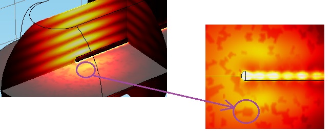

Where are these strange spots come from? (V4.2 RF module)
My model is to stimulate a Ag nanowire with a gaussion beam, it's in 3D.
When I mapped the field distribution, there come lots of strange spots. see the attachment.
1. Do you guys have seen this befor? How to clear them ?
2. Do these sopts will influence the exactness of my result ?

What exactly are you shwing us the EM field ?
for me it looks like some standing waves, not astonishing if you have multiple reflections from interfaces
Hi What exactly are you shwing us the EM field ? for me it looks like some standing waves, not astonishing if you have multiple reflections from interfaces -- Good luck Ivar

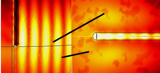

My problem is not the standing wave, it's the fleck. I attach another PIC, and it's Enorm
Posted: 1 decade ago 01.03.2012, 05:33 GMT-5
I beleive that is your mesh pattern, always check your mesh results by changing under Plot Quality: smooting : none and Wireframe grid
Hi I beleive that is your mesh pattern, always check your mesh results by changing under Plot Quality: smooting : none and Wireframe grid -- Good luck Ivar
