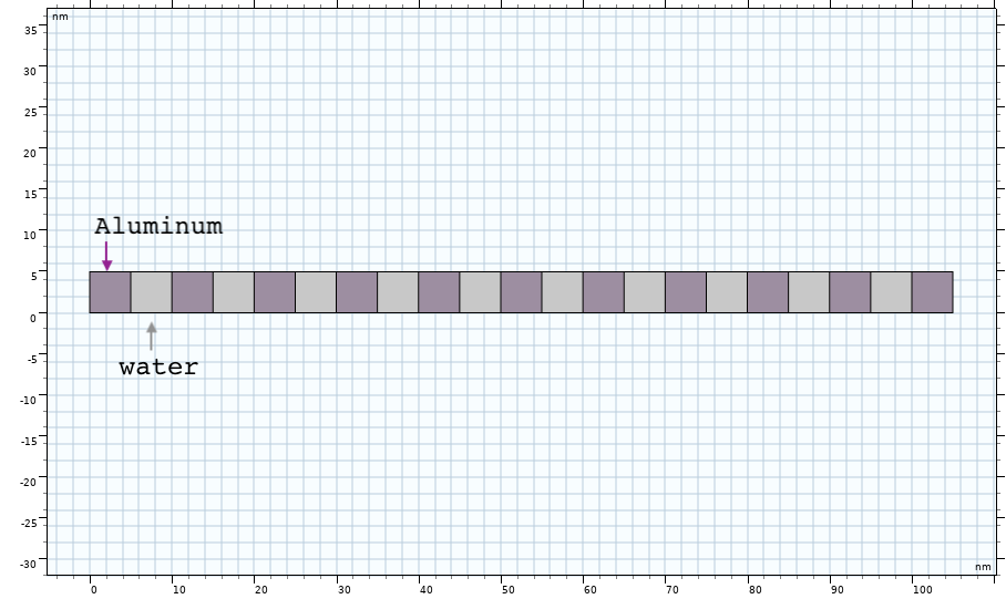

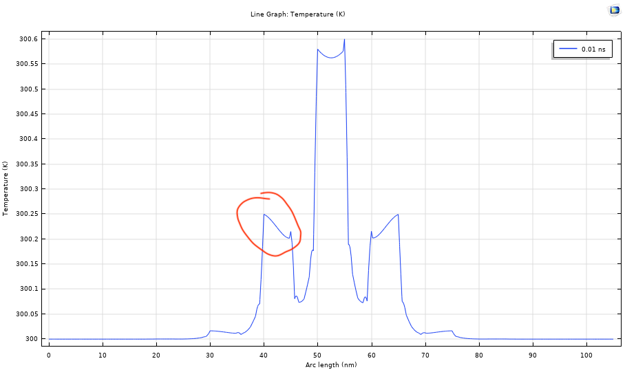

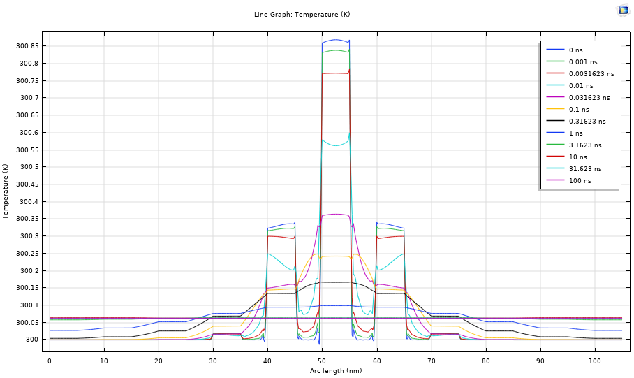

To illustrate the problem, I made a simple mock file (attached) that has a 2D geometry of alternating metal and water square domains (picture attached), where the initial temperature of the water is 300 K and the metal has a linear Gaussian profile of elevated temperatures spanning multiple domains. At early times (0-0.1 ns, picture attached) there are temperature spikes at the interface, and at some time points (0.01 ns, picture attached) the temperature profile within some domains is somehow inverted from expected, and at later times the whole temperature profile is inverted from expected with lower temperature in the center than the edges (10 ns, picture attached). In this case I established an interface conductance that is relatively high (faster than the timescale of the simulation), but the problem persists. I've also seen similar problems even with a slab of say metal with a 2D Gaussian temp profile, including ripples and spikes in the temperature profile.

If you look at the Y-axis legend for the 10 ns plot, you will see that there is only one single value. What you see is just numerical noise of the order of 1 mK. In practice, the value is constant.
By plotting T-300 or T-300.063 instead of T you can examine the values more in detail.
As for the ripple at small times, that will probably decrease if you tighten the tolerance by some orders of magnitude.

Thank you Henrik, that made a big difference but I wouldn't have thought to look at the study tolerance to fix it on my own! That also flipped the 10 ns plot to a physically meaningful orientation (though I understand the actual values should be taken with a grain of salt).
