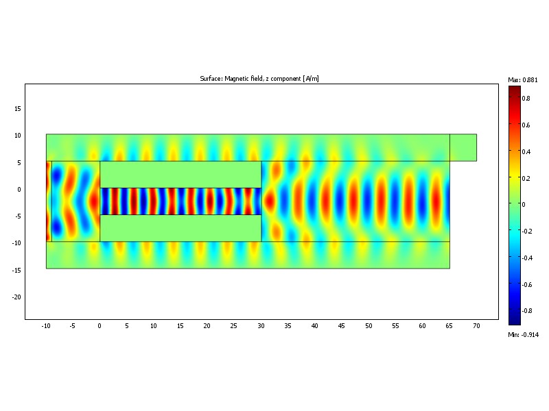

After simulation I got this.. But why is the light entering the dielectric in between. Should it not be like this?
img546.imageshack.us/img546/3599/poog.png
Thank you for the help

I want to know why the light penetrates the dielectric surface when the plasmons are supposed to travel at the interface alone

1. Mesh finer (refine mesh 1-2 times)
2. At the same time reduce the size of the simulation domain where you do not need it.
3. I am not sure about your scales, but from my feeling you dimensions with respect to the wavelength are off. The wavelength should be larger or the dimensions smaller, not sure what you are trying to do with this model? Is this a real physical system you are trying to model?
Doing this, I get some results (see file in the attachment).
Let me know if this is what you are looking for?
Also it seems the file problems you were having were related to firefox? I just had a similar problem, where attaching a file did not work with firefox, but the same file was okay with internet explorer....
