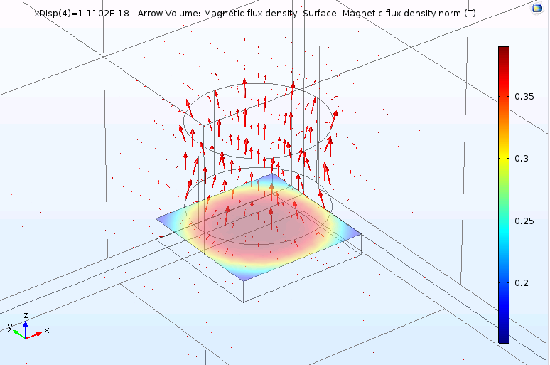

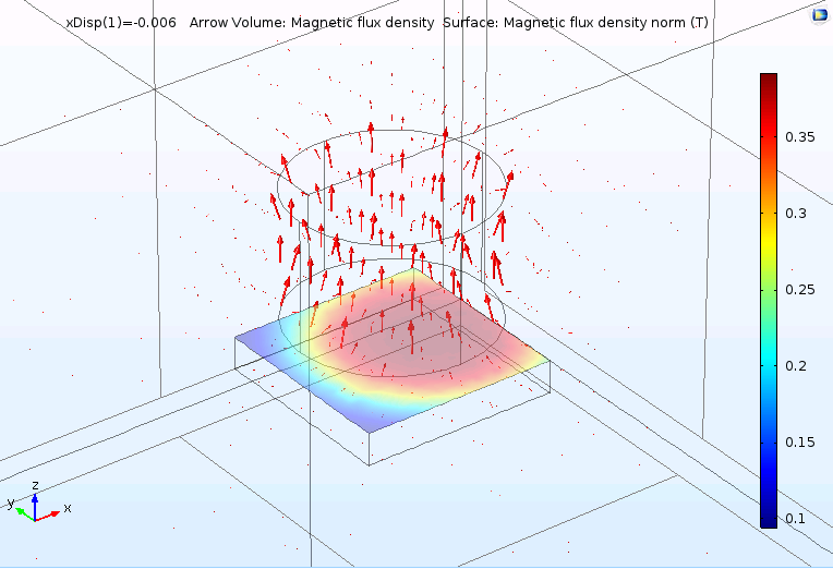

So far, I've built a model with a cylindrical magnet (with defined remanent flux density) and a copper plate placed under the magnet, separated by an air gap. I added a Moving Mesh physics with a Presribed Mesh Displacement on the plate boundaries and a Free Deformation in the model volume. A Parametric Sweep of the displacement of the plate mesh solves successfully, and gives a changing magnetic flux through the top surface of the plate. (MovingPlate_ParametricSweep.mph plus a couple of screenshots attached.)
