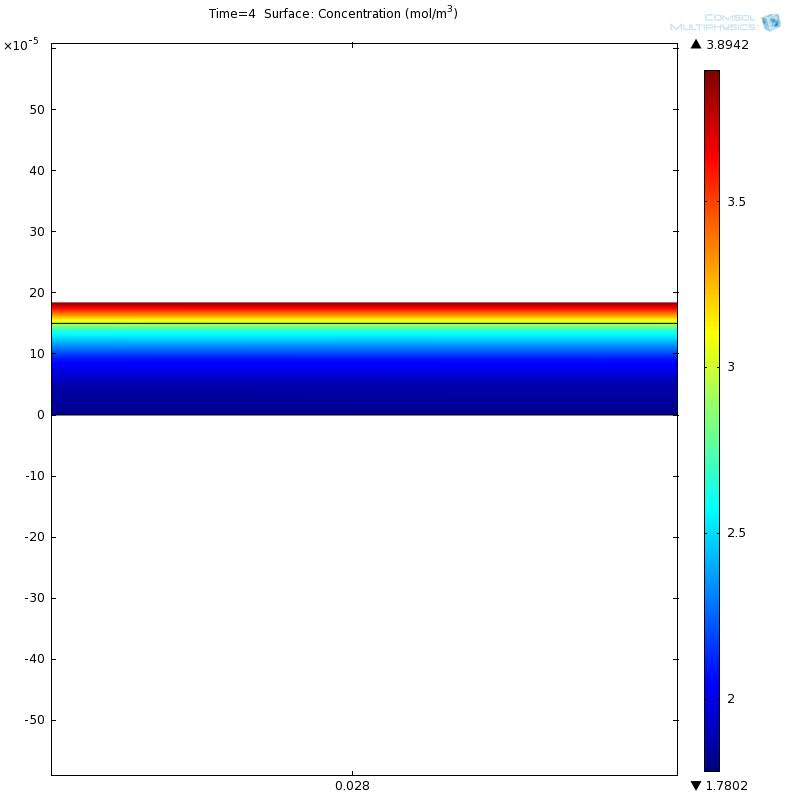

The problem I have is that the concentration in the chamber increases near the boundary where I set the Moving Wall.
There is no physic explanation of that, and I don't know how to solve. I tried changing the Coordinate System, but I don't know if the problem is there, and it didn't work.
In the attachment there is an image of my result.

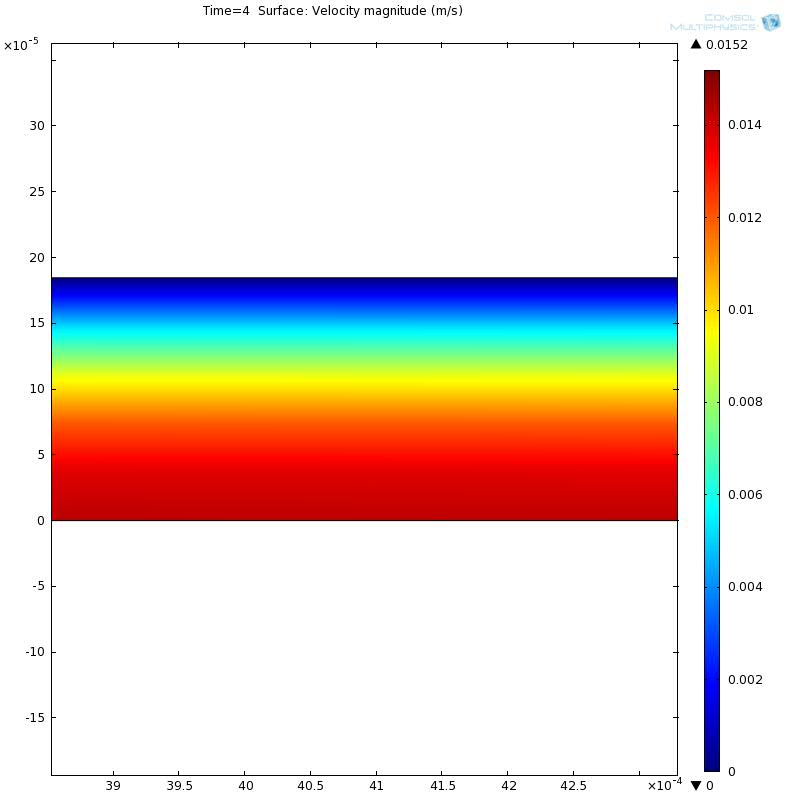

thank you for your answer.

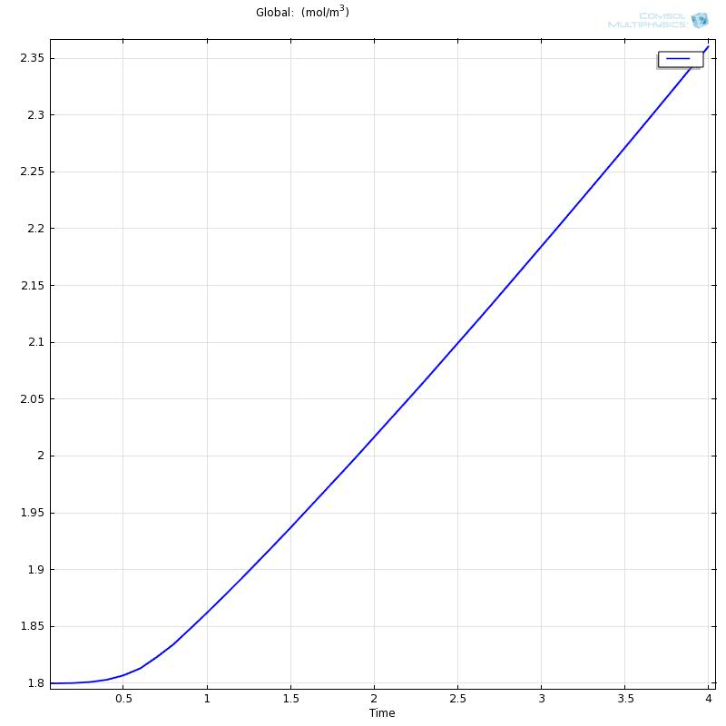

The velocity seems to be correct, it's 0 m/s near the moving wall, as you can see in the attachment (I forgot to say that there is a symmetry on the bottom boundary, but I have the same problem without the symmetry condition).
In the second attachment there is a graph of the average concentration in the chamber. I'm expecting the average concentration to be constant in time, but it's increasing, and I don't know why.
Daniele

Today I tried to reduce the chamber size, instead of expand it, and I found that there is the same problem, but the concentration near the moving wall in this case decreases!
I can't find any solution, could anybody help me?
Today I tried to reduce the chamber size, instead of expand it, and I found that there is the same problem, but the concentration near the moving wall in this case decreases! I can't find any solution, could anybody help me?
