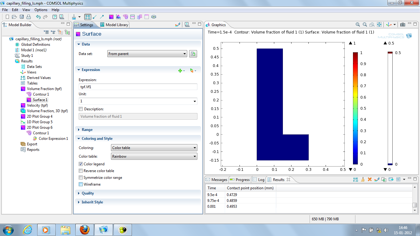

My display of result is not proper, as in capillary rise by ls method (same as in model library), The surface plot is in same color throughout! I couldn't distinguish between the phases. Kindly let me know what is to be done to correct this!
PS: Kindly take a look at the surface plot screen shot.

Try Edit -> Clear All Meshes and Edit -> Clear All Solutions, and re-run the simulation. I've had instances where the result of a previous simulation was displayed if I did not clear it first.
