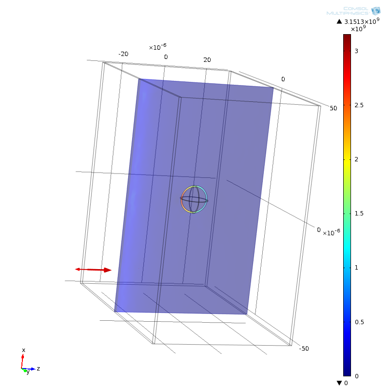

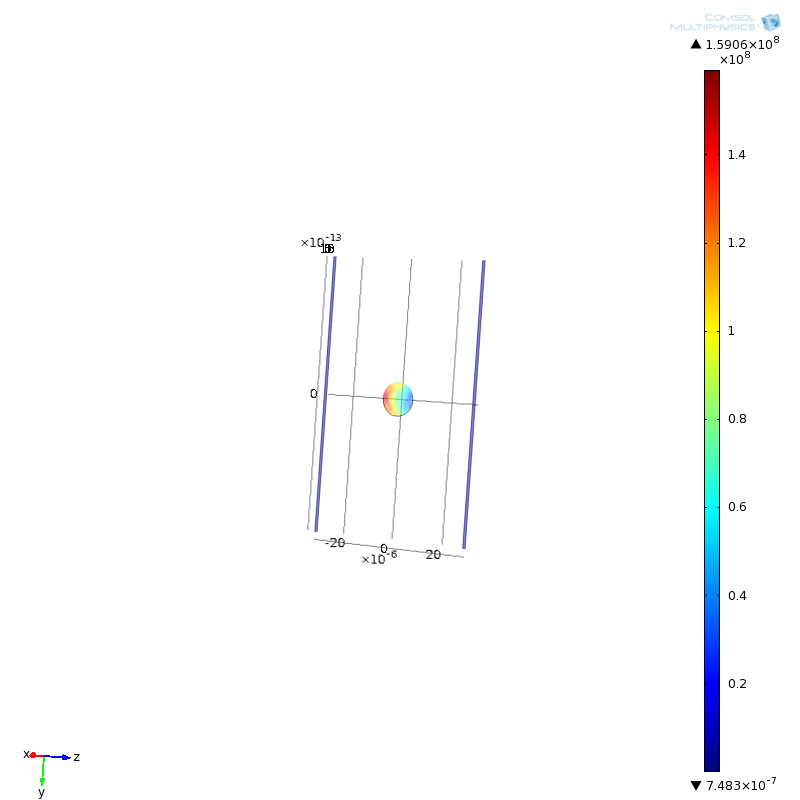

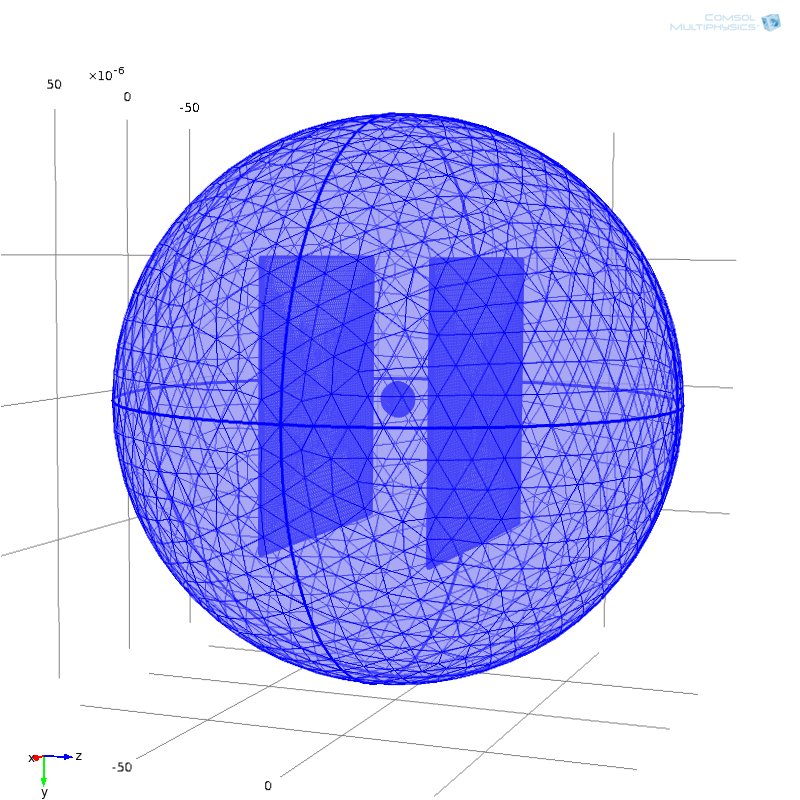

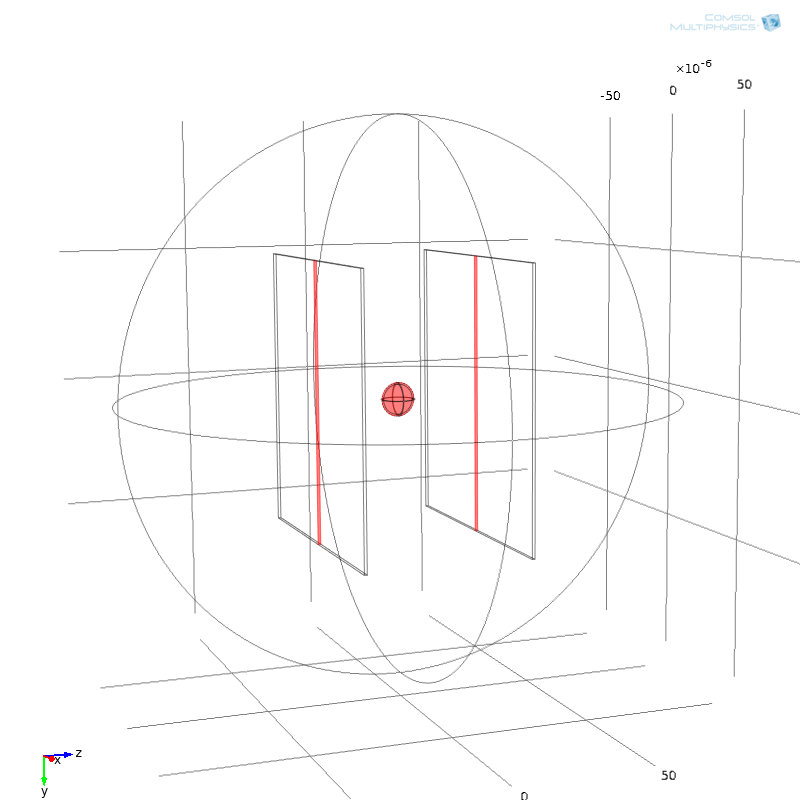

I am studying the effect of electric fields on cells, so I made ​​a simple model of this. The cell was modeled with a sphere with certain thickness, which represents the cell membrane and two electrodes where the electric field is applied. All this is covered by another spheroid that emulates the blood or extracellular fluid.
However, I have a problem when trying to make a cut plane (right click on data set->cut plane). I was able to plot the cell and the electrodes but not the extracellular fluid. Has anyone had a similar problem? Anybody know how can I solve this problem? Thank you in advance for any help,

I've had similar problems. Not with cut planes though, but with slice plots, which aren't all that different.
In my case, the problem seemed to be related to the Views I had defined in the Model/Definitions section (not under Results). If one of those Views would hide some geometric objects (such as the outer sphere in your case), that part wouldn't show up in the slice plots even though I had specifically selected some other View which included all domains.
It would then help to switch back and forth between Views. It was often a little erratic like that, but eventually Comsol would plot the graph in all domains.

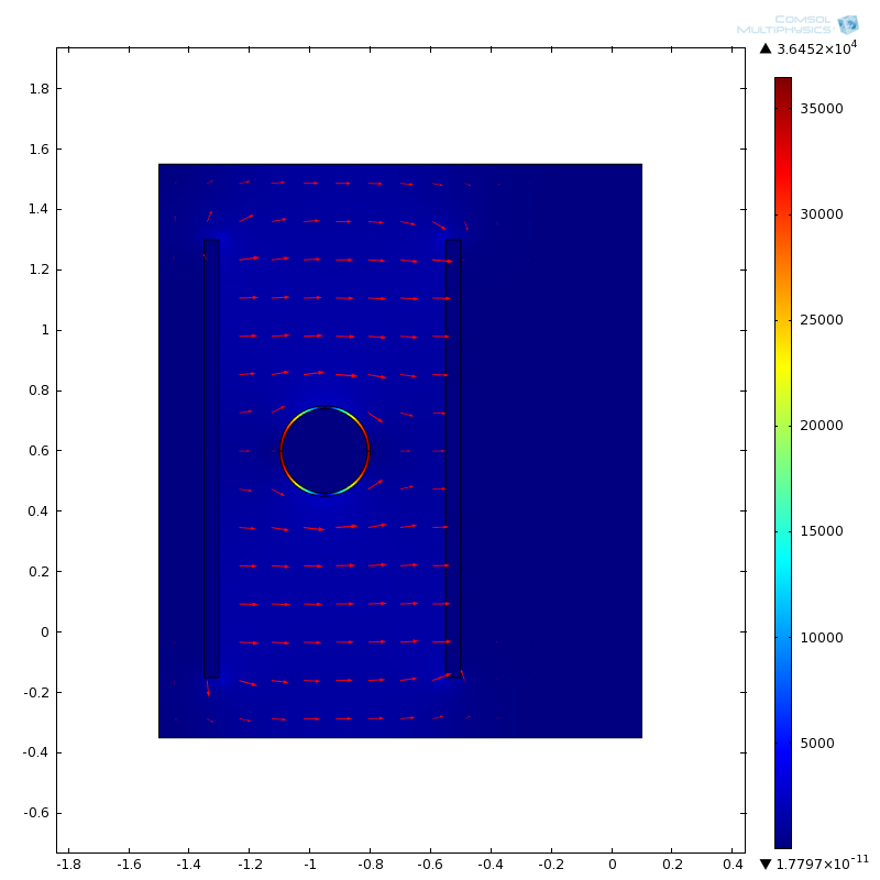

Hi John,
Thanks for your quick response; your comment has helped me to represent the part I needed.
However, the result is not that I expected, the electric field asymmetrical (attached figure) , when it should be symmetrical about the center. In addition, the electric current arrows are out of the slice, have you had the same problem?. There is someone who has previously resolved?
Thanks in advance,
Michael.
PD: I attached two images, one with the slice and other with the expected slice.
