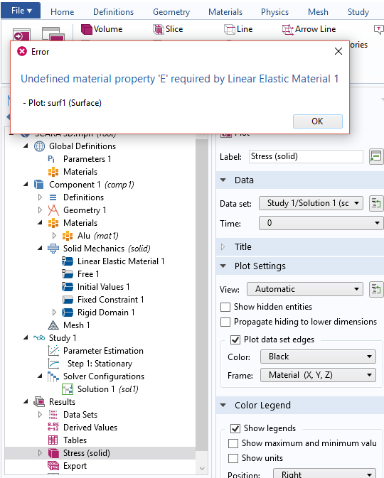

Undefined material property 'E' required by Linear Elastic Material 1
This should be really easy but its driving me nuts. This is the error I get when I hit compute:
Undefined material property 'E' required by Linear Elastic Material 1 - Plot: surf1 (Surface)
I'm sure I have E set as a parameter and used in my material with the right variable and value. I've given this value multiple different names or just typed in the number and still it cannot seem to be used by comsol. Other variables are not giving me any troubles.
I've also tried to set the E at Linear Elastic Material 1 to user defined instead of material and gave the right value but to no avail.

Posted: 6 years ago 19.09.2019, 09:22 GMT-4
Hello DV, The file you posted doesn't seem to have the "Parameter estimation" node set up. Maybe it's the wrong file?
If I disable that node, the plot is generated without problem.
I also noticed that in the screenshot you attached in your first post there's a reference to a time t=0 in data set 1, which seems wrong since you don't have a transient analysis in the model. Perhaps it was left over from a previous iteration of your model?

Posted: 6 years ago 23.09.2019, 08:58 GMT-4
Hi D V,
Your file still contains that dubious reference to a time t=0 in the Stress plot group, so I simply solved the model (i.e. I right-click on the Study node and select Compute) and the plot comes out nicely.
Jeff Hiller
Hi D V, Your file still contains that dubious reference to a time t=0 in the Stress plot group, so I simply solved the model (i.e. I right-click on the Study node and select Compute) and the plot comes out nicely. Best, Jeff
Posted: 6 years ago 23.09.2019, 09:02 GMT-4
Ah right, I got it to work. I think the problem was indeed the t=0. Thank you very much!
