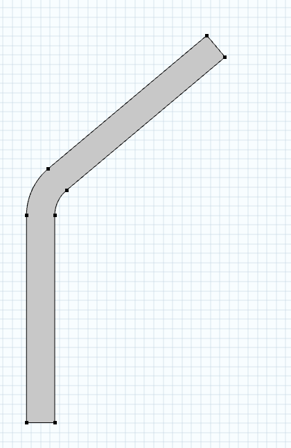

I want to simulate a bending microchannel. In the simulation i want to do a parametric swwep of the bending angle in the range(10,5,180).
when creating the geometry of the channel, i used parametric curves for the bending radius. The thing is i want the length of the channel to remain constant when sweeping between angles. So far i created a channel and everything went fine, except for example when the angle is 80, the length of the channel would be different from when the angle is 90 etc. How can i proceeed ?

There are several ways the length of the channel could remain constant while you vary the angle of the bend: the bottom straight section could vary in length while the top straight section remains of constant length, or the top straight section could vary in length while the bottom straight section remains of constant length, or both straight sections could vary in length; so you have some decision to make there. Also, I presume that it is the midline of the microchannel that you want to keep of a constant length, but perhaps it is one of its edges; this is not entirely clear to me from your post.
In any case, you can implement any of those constraints by using the fact that the length of an arc of circle is , where is the angle expressed in radians and is the radius, and specifying the length of either or both of the straight sections accordingly in terms of.
