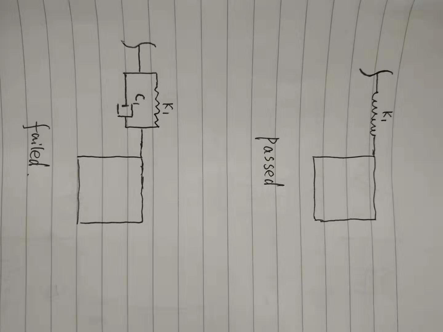

Dear Leon,
Try using Velocity node instead of Displacement node to prescribe the motion when you have a damper in parallel to a spring. This should resolve the problem.

Dear Leon,
Pawan Soami
With the Velocity node instead of Displacement node, it works in the ‘Time Dependant Study’, but it does not work for the 'Eigenfrequency Study':
- Feature: Eigenvalue Solver 1 (sol2/e1)
Singular matrix.
- Detail: There are 1 void equations (empty rows in matrix) for the variable comp1.lms.vel1_p1_u.
at coordinates: (0,0,0), ...
