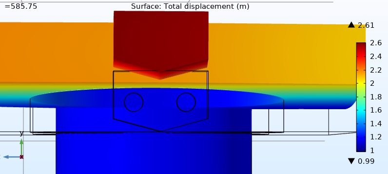

So I have the results of an eigenfrequency analysis, and would like to find out how much an object has rotated in a certain plane. For instance, in the picture below, I'd like to find out how much the front surface of the "red" block there has rotated in the y-z plane. I extracted the displacement data of the upper corners of the block, and used their initial positions to calculate the final position of each corner, and then use arc tan to find the angle. But I'm getting 45 degrees instead of approximately 0, as what the picture below indicates. What's wrong with my approach, or maybe anyone knows how to extract rotation of a certain plane directly (rotation of projection of the plane onto a plane on the yz axis) from COMSOL?

That sounds like a mere trigonometry mistake. If you have the coordinates of: * O: the center of rotation * A: the initial point * B: the displaced point
then, assuming the rotation is around the x-axis
So to get the rotation angle, that is you can input in COMSOL
theta_A = acos((y_A - y_O)/R) * if(z_A > z_O, 1, -1)
theta_B = acos((y_B - y_O)/R) * if(z_B > z_O, 1, -1)
theta = theta_B - theta_A
Add this if R is not fixed by design
R = sqrt((y_A - y_O)^2 + (z_A - z_O)^2)
There might well be a more efficient way. Also, with these definitions and the same applies to so when you substract the two, the result might not be what you expect. Change > to >= for or add and a modulo operation to get
Hi, That sounds like a mere trigonometry mistake. If you have the coordinates of: * O: the center of rotation * A: the initial point * B: the displaced point then, assuming the rotation is around the x-axis R = ||\vec{OA}|| = \sqrt{(y_A - y_O)^2 + (z_A - z_O)^2} y_B = y_O + R \cdot \cos(\theta_B) z_B = z_O + R \cdot \sin(\theta_B) y_A = y_O + R \cdot \cos(\theta_A) z_A = z_O + R \cdot \sin(\theta_A) So to get the rotation angle, that is \theta_B - \theta_A you can input in COMSOL theta_A = acos((y_A - y_O)/R) * if(z_A > z_O, 1, -1) theta_B = acos((y_B - y_O)/R) * if(z_B > z_O, 1, -1) theta = theta_B - theta_A Add this if R is not fixed by design R = sqrt((y_A - y_O)^2 + (z_A - z_O)^2) There might well be a more efficient way. Also, with these definitions \theta_A \in [-\pi;\pi[ and the same applies to \theta_B so when you substract the two, the result might not be what you expect. Change `>` to `>=` for \theta_A \in ]-\pi;\pi] or add 2 \pi and a modulo operation to get \theta_A \in [0;2\pi[
