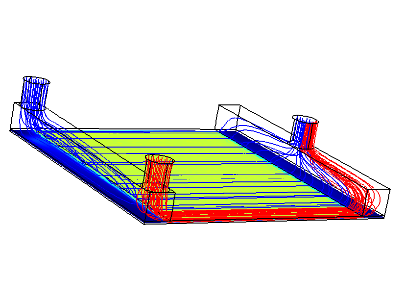

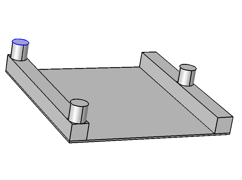

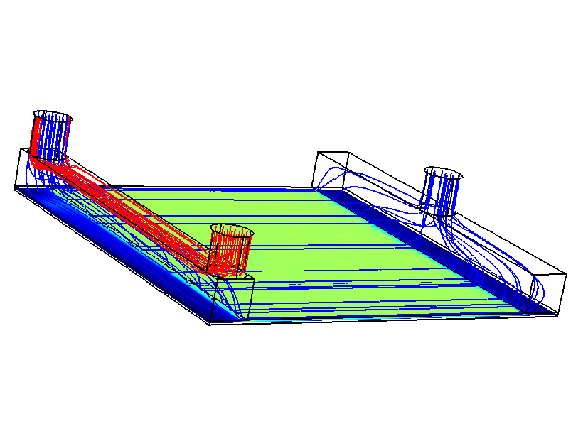

Hello Claus,
I downloaded your files and I think, your problem can be solved! Do you already get a sufficient solution?
I give you some hints from my point of view:
1.) Use a mesh, that is fine enough to resolve the lower thin flow domain. There should be more than one elements in y direction.
2.) May be the pressure/pressure BCs don't result in a stable solution. In this case you can combine the velocity inlet BC with ODEs in such a way, that the velocities are calculated to give the appropriate pressures.
If I can help you please contact me. You can also use my e-mail adress: "michael.rembe@rembe-consulting.de".
Best regards
Michael

Claus, did you check if your flow is laminar or turbulent?
Regards, Michael

Claus,
I checked your model. All boundary conditions (BC) as pressure BC can not work! Because there are differences between the pressures of the two inlets the fluid must flow out of the "inlet" with the lower pessure! There is a small pressure gradient!
It is a nunmerical problem. Because water nearly is incompressible in reality backflow is prevented by pumps or valves.
May be you can use an average pressure for both inlets. Solve for the steady state flow. Then change the pressures and solve for the transient flow. This will give you a more smoother solution.
What do you want to evaluate with your simulation?
Best regards
Michael
