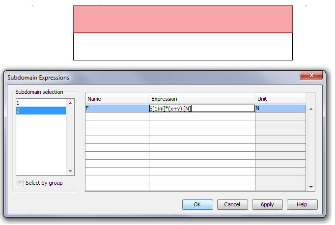

Only one thing is that I'm trying to vary the value of the Volume force based on the point in the bulk of the fluid i.e. to define the force in terms of x and y..
So I went to options, expressions and put F....Comsol couldn't identify F, and there was no option to define F as a force, since the description place could not be changed.
Then I tried defining the for as say F=5(x+y) Newton....and it kept giving an error!
I tried the same in Options--> Functions, and again with no luck.
Please tell me what could be wrong!

I can see no error in the expression..have a look at the attached pic file...
cheers
I can see no error in the expression..have a look at the attached pic file... cheers

Thanks! It worked...just 2 quick questions:

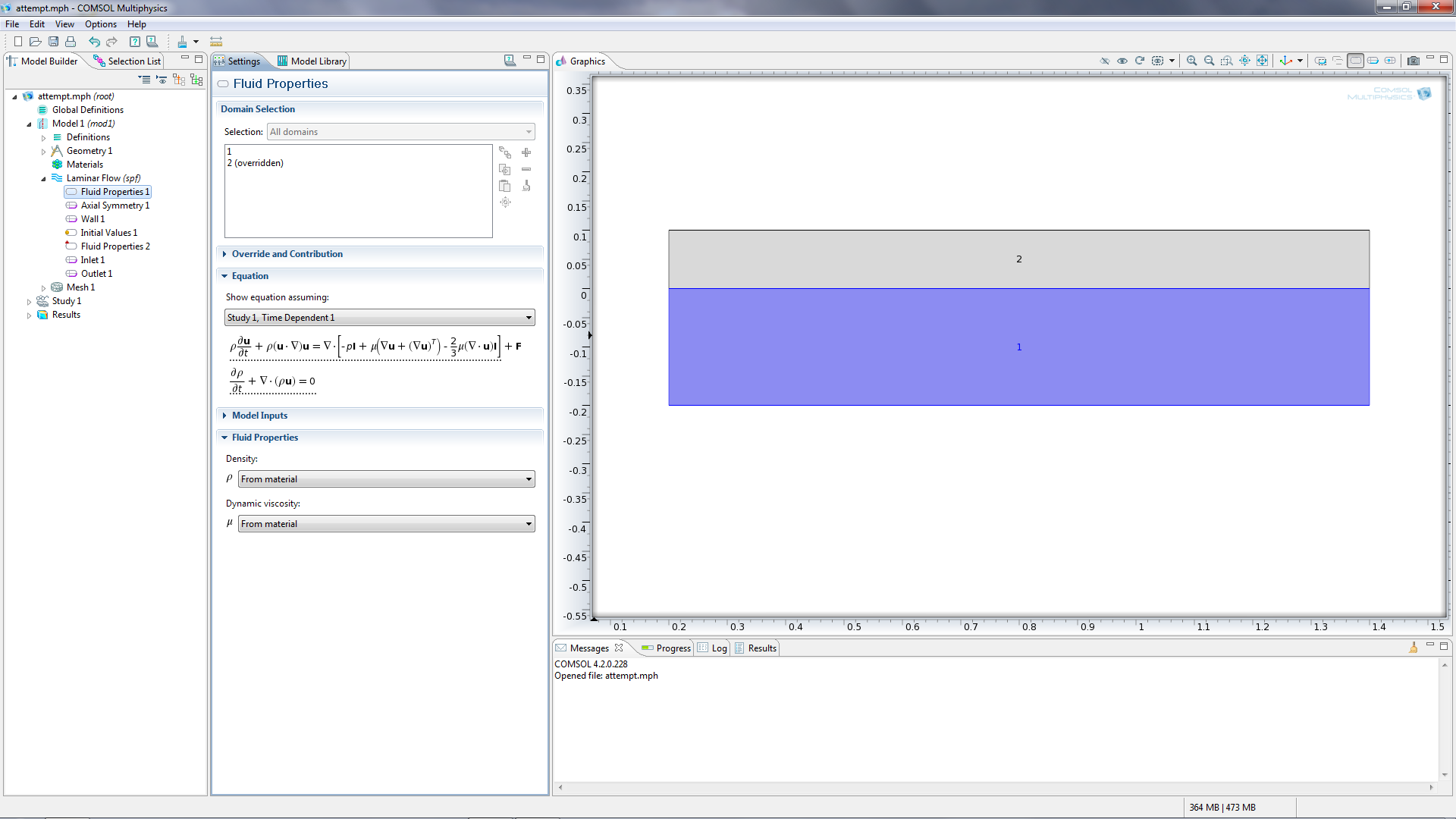

Posted: 1 decade ago 02.12.2011, 00:41 GMT-5
Due to certain problems, I've had to shift to COMSOL 4.0 version...in this, a unique problem that I'm facing is that when I select boundary conditions, whatever I apply to any one boundary gets applied to all of the boundaries...so basically I'm not being able to specify separate boundary conditions for each boundary...please help!
Hi, Due to certain problems, I've had to shift to COMSOL 4.0 version...in this, a unique problem that I'm facing is that when I select boundary conditions, whatever I apply to any one boundary gets applied to all of the boundaries...so basically I'm not being able to specify separate boundary conditions for each boundary...please help!

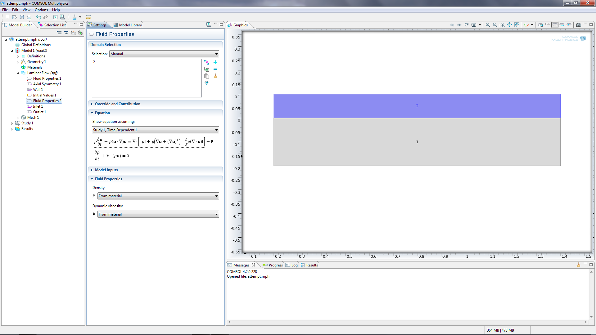

Posted: 1 decade ago 02.12.2011, 08:04 GMT-5
There's a place in the settings window, where it says 'All domains'...so whatever settings I apply to any one domain applies to all of them...all the boundaries etc etc...somehow I just can't change that....there's no option to make it from 'All Domains' to specified domains...
I really haven't done very much..I'm just trying to assign different boundary conditions to each of these boundaries..
Btw, what kind of problems did 4.0 have...I'm using 4.0,not 4.2....will they seriously disturb my work?
There's a place in the settings window, where it says 'All domains'...so whatever settings I apply to any one domain applies to all of them...all the boundaries etc etc...somehow I just can't change that....there's no option to make it from 'All Domains' to specified domains... I really haven't done very much..I'm just trying to assign different boundary conditions to each of these boundaries.. Btw, what kind of problems did 4.0 have...I'm using 4.0,not 4.2....will they seriously disturb my work?
Posted: 1 decade ago 02.12.2011, 10:31 GMT-5

Posted: 1 decade ago 03.12.2011, 01:05 GMT-5
Hi!
Thanks...you're awesome :-)
I've now learned how to add stuff....now when I specify each boundary-type, it gets added as wall2 or open boundary 1 etc ...but the default boundary condition as you mentioned in your last post still remains....will that affect my solution, or should I try deleting it, since I really don't want it...?
I'm not sure what's happening, but I'm getting an error:
Failed to evaluate variable Jacobian.
- Variable: mat.rho
- Geometry: 1
- Domain: 1
I've attached the file..its a simple case with only one region...I'm just doing a simple case in which I apply a bulk force and all my boundaries except for the bottom one(wall) are open boundaries...
I just want some valid output...
Thanks for your help!
Hi! Thanks...you're awesome :-) I've now learned how to add stuff....now when I specify each boundary-type, it gets added as wall2 or open boundary 1 etc ...but the default boundary condition as you mentioned in your last post still remains....will that affect my solution, or should I try deleting it, since I really don't want it...? I'm not sure what's happening, but I'm getting an error: Failed to evaluate variable Jacobian. - Variable: mat.rho - Geometry: 1 - Domain: 1 I've attached the file..its a simple case with only one region...I'm just doing a simple case in which I apply a bulk force and all my boundaries except for the bottom one(wall) are open boundaries... I just want some valid output... Thanks for your help!
Posted: 1 decade ago 03.12.2011, 01:32 GMT-5
I have looked at your model file..it seems these are not big problems and you need more practice to understand how new version of Comsol works..so i recommend to do practice by solving few already solved problems using Comsol 4.0 or 4.2 documentation.
Posted: 1 decade ago 03.12.2011, 19:11 GMT-5
I almost figured it out...it turns out that the problem was that I didn't select any material...only thing now is...how do I see the solution at each time step?..in 3.5a, I had got it from the plot menu, but in the equivalent 'study' menu on version4.0, there doesn't seem to be any such option.
Hi, I almost figured it out...it turns out that the problem was that I didn't select any material...only thing now is...how do I see the solution at each time step?..in 3.5a, I had got it from the plot menu, but in the equivalent 'study' menu on version4.0, there doesn't seem to be any such option.
Posted: 1 decade ago 03.12.2011, 20:18 GMT-5
right click on Results, plot whichever plot you want to plot....easy. In new versions of Comsol, right click is very important..you can go any place and right click and make your path. You can read chapter 6 of attached reference guide.
