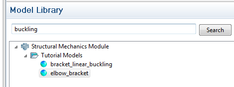

I cant find the buckling analysis. In which module is it? What is the exact name?
Peter
Dear Ivar, I cant find the buckling analysis. In which module is it? What is the exact name? Best regards, Peter
Posted: 1 decade ago 17.08.2011, 06:17 GMT-4
I find them here, but indeed you need the structural module, forgot about that
Hi I find them here, but indeed you need the structural module, forgot about that -- Good luck Ivar

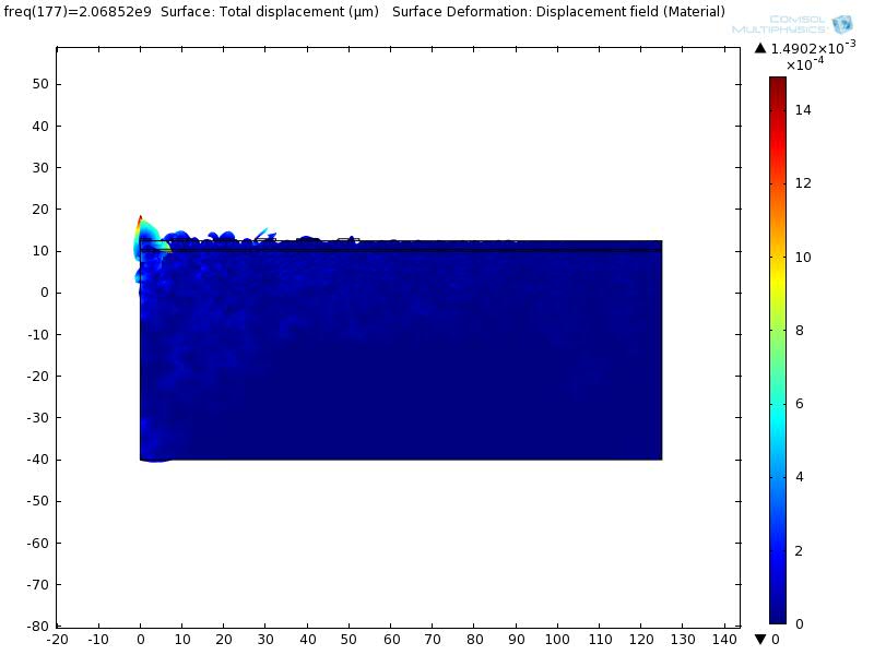

Hello Iyar,
I found another problem in my simulation. I have simulated the acoustic wave based on the 2D axisymmetric simulation. Due to this I allways get a serious problem here, even Im not in the resonance frequency. Please find attached my result. There is no nice SAW in, because of the symmeric condition. Need your advice here,
Peter
