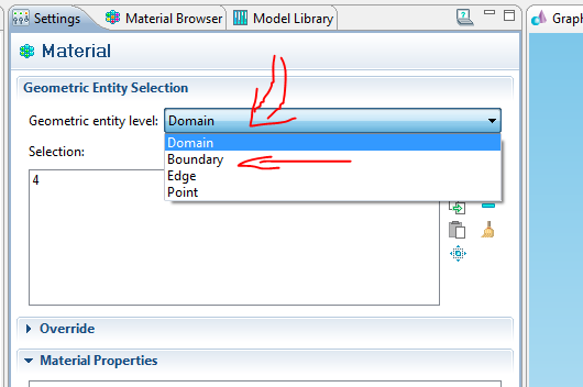

I'm not sure I catch all, but
Have you tried to define a second material node (same material as the bulk) and apply them to the boundaries ?
Or you might specify a boundary material property manually in the boundary physics node
Hi I'm not sure I catch all, but Have you tried to define a second material node (same material as the bulk) and apply them to the boundaries ? Or you might specify a boundary material property manually in the boundary physics node -- Good luck Ivar
