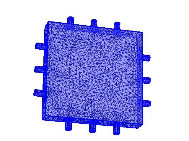

I have a problem to analyze the flow motion within this cell(figure). It's basically a box with 6inlets and 6outlets. I've put an inlet mass flow and an environmental pressure at the outlet, the problem is that I can't visualize the motion within the cell. I would get the video of how the flow fill the box with the passage of time.

There are several issues with your model. First of all, you are subtracting the domain where you impose the laminar flow so that you actually obtain a cavity rather than a volume. You just need ti build all the extrusion and form a union, just forget about the block, the differences and the assembly.
Second, you need to rewrite a bit you inlet and outlet conditions after you check it is actually laminar flow, according to my calculations you have a Reynolds number of about 3000, I would say you have transition flow, so you also need to have a fine mesh, in your model there is only a lonely size and no elements.

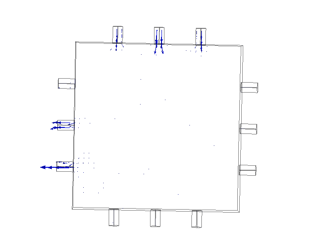

I've changed the model, I drawn just the water dominium which I want to study.
Now, do you know how could I see a video over liquid movement within the cell?

I haven't tried your model yet, I have not much time, but I am curious did you really get a convergent solution? Your inlet and outlet do not reach the desired value increasing slowly over time, they are already set at the beginning of the simulations. It would be surprising if the solver can converge that easily. Furthermore, you may wan to specify something besides the boundary layer mesh and the size, maybe something like free tethraedals or you may be able to use a swept mesh.
Anyway, if you already have the solution all you have to do is select the plot your interested in, I guess Velocity would be good enough, then you need to click on the small button on top which says 'Player' it will automatically create a video in comsol of how the velocity varies in time, then you can export the comsol video into some other format such as media player.

after a while I got results so I guess it has reached convergence(I had even changed the velocity so now Re is about 300). I've used a boundary layer mesh(image attached), honestly don't know why..

I did run the simulation and I am surprised it converged, there are still some issues regarding the mesh mostly. Boundary layer mesh is a 'must' in CFD but it might be better to have it finer by reducing the distance of the first layer form the wall. Again, it may be a good idea to try a real mesh, not only the size feature but actually write down something about free tethraedals or use a swept mesh.

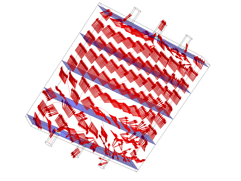

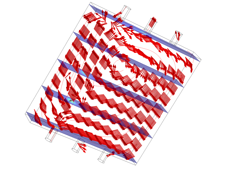

If you look at the pictures you can clearly see the arrows pointing from the inlet to the outlet, there is a lot of recirculation but it is fine, all in all the model seems to be working properly, and remember you defined one inlet and one outlet only. One picture was taken after 3 seconds and one after 30 seconds.

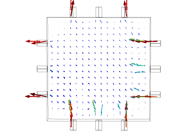

I've run a new model(model6 below) with more inlets and outlets, the result as you can watch in the picture is that the fluid is moving in the opposite way, I guess it is because of the Volume force but I don't know how to solve it.

I've run it without the Volume force and that is the image I got, that makes more sense to me, even if I know that isn't completely right.

You need to make sure first of all what you need in your model and then you may decide upon volume forces and so on, but I noticed you have not defined a mesh and you have not defined entrance lengths for the inlets nor for the otulets and you can see that the amount of mass flowing out of your domain is greater than the mass flwoing in even with fewer inlets and with the volume force acting.
