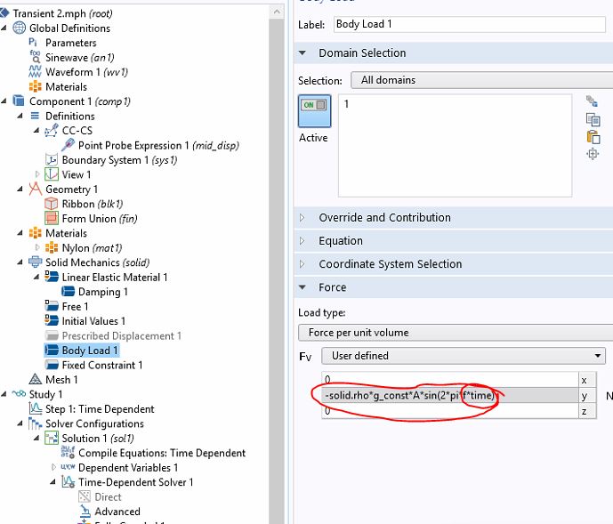

How to apply a time dependent sinusoidal body load?
I have a solid mechanics module + time dependent study. How can I apply a sinusoidal time dependent load (to simulate sinusoidal base excitation)?

@D Greve, thanks for the reply.
Hi I am looking for nonlinear (geometric) large deflection response and I think time dependent would be most apt.
I am trying to apply the load (base excitation) as a body force (as shown in the snapshot attacked to my 1st post). Any suggestions?

Posted: 7 years ago 23.08.2018, 07:22 GMT-4
You can type a mathematical expression like the one in your screenshot, but the variable for time is "t", not "time".
Jeff Hiller
You can type a mathematical expression like the one in your screenshot, but the variable for time is "t", not "time". Best, Jeff
Posted: 7 years ago 23.08.2018, 10:58 GMT-4
In that case I agree you will need to do time dependent analysis.
Be aware that the system may take a very long time to reach steady state if it is lightly damped. Running a very long time-dependent simulation takes considerable computation time and may diverge.
> Hi I am looking for nonlinear (geometric) large deflection response In that case I agree you will need to do time dependent analysis. Be aware that the system may take a very long time to reach steady state if it is lightly damped. Running a very long time-dependent simulation takes considerable computation time and may diverge.
