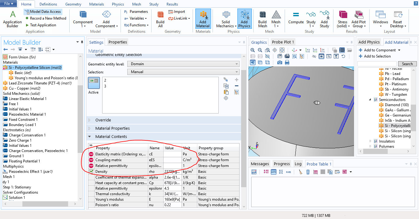

I have noticed that sometimes when Si or Cu is used as a material for piezoelectric or piezoresistive simulations, comsol gives empty Elasticity and Coupling matrix. hence i have to manually input those matrixes in order perform simulation further more. So what is this?
I have attached a screenshot.

I understand that. But how can I make them Linear Elastic material. I am trying to harnest energy using Piezoelectric material. So that I need electrodes to capture that potential.

Delete the electrodes from the piezoelectric subnode and they will automatically appear in the linear elastic default node.

Note that a linear elastic material can still be part of the solution in the Electrostatics interface, it is just that the electric and mechanical fields are uncoupled. So you need to remove those domain also from Charge Conservation, Piezoelectric so that they appear in the selection for the default Charge Conservation node.
