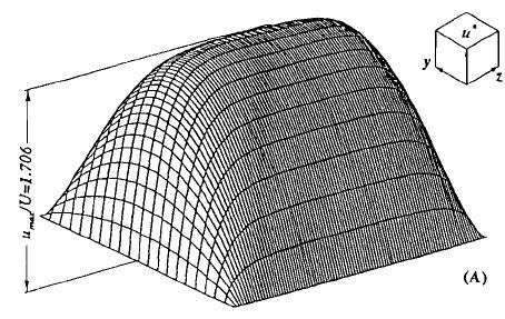

Currently, I would like to plot a velocity profile for newtonian fluid which is in 3-D ( which means I want a diagram with 3 axis and show a U-curve-laminar flow)
Actually, what should I do for the settings to create 3-D velocity profile? I do know there is a 3D-cut line setting to show a 1-D curve of velocity magnitude, but I have no idea for 3-D curve.
Please find the attached file for your reference.

if I understand you well you got a line curve (in 2 dimensions) from a cut line,
so for me if you follow the same logic, by using a cut surface you will get a surface plot "with height" (in 3 dimensions)

First, I right click on the data sheet and choose to add the "surface" and select the desired boundary.
After that, I right click on the 3D plot group and I choose to add the "surface". However, It does not show me the diagram with height but only a flat surface. Is it any setting i did wrongly? Or should I not to click the surface but others?

for a surface selected in the data set you need to add a 2D surface plot group (check that it points to the newly created data set) and then a surface plot node where you define your variable(s) and then right click this surface node and add a "heigth view" option

Hi Ivar,
A lot thanks to you!!
Its helps!
