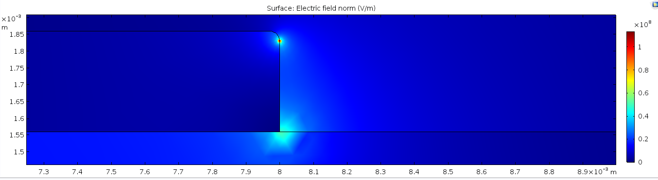

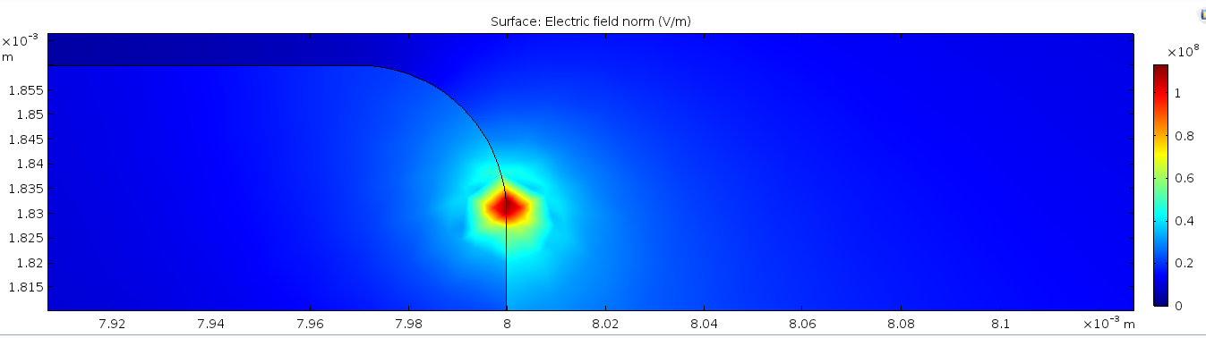

I am doing doing a study of the electric field in a simple geometry but it looks like due to the resolution of the geometry i am getting incorrect results. Where a corner is rounded, it appears to have a sharp corner at the point where the fillet ends which results in a higher than expeced e-field. Is there a way to get rid of this corner so I get accurate results? Two images are attached.

In case anyone ever has this same issue, I used "Form Composite Edges" under geometry and added the two edges and the fillet. It did make a difference in the values measured with a probe some distance away so this may be valuable to know.
