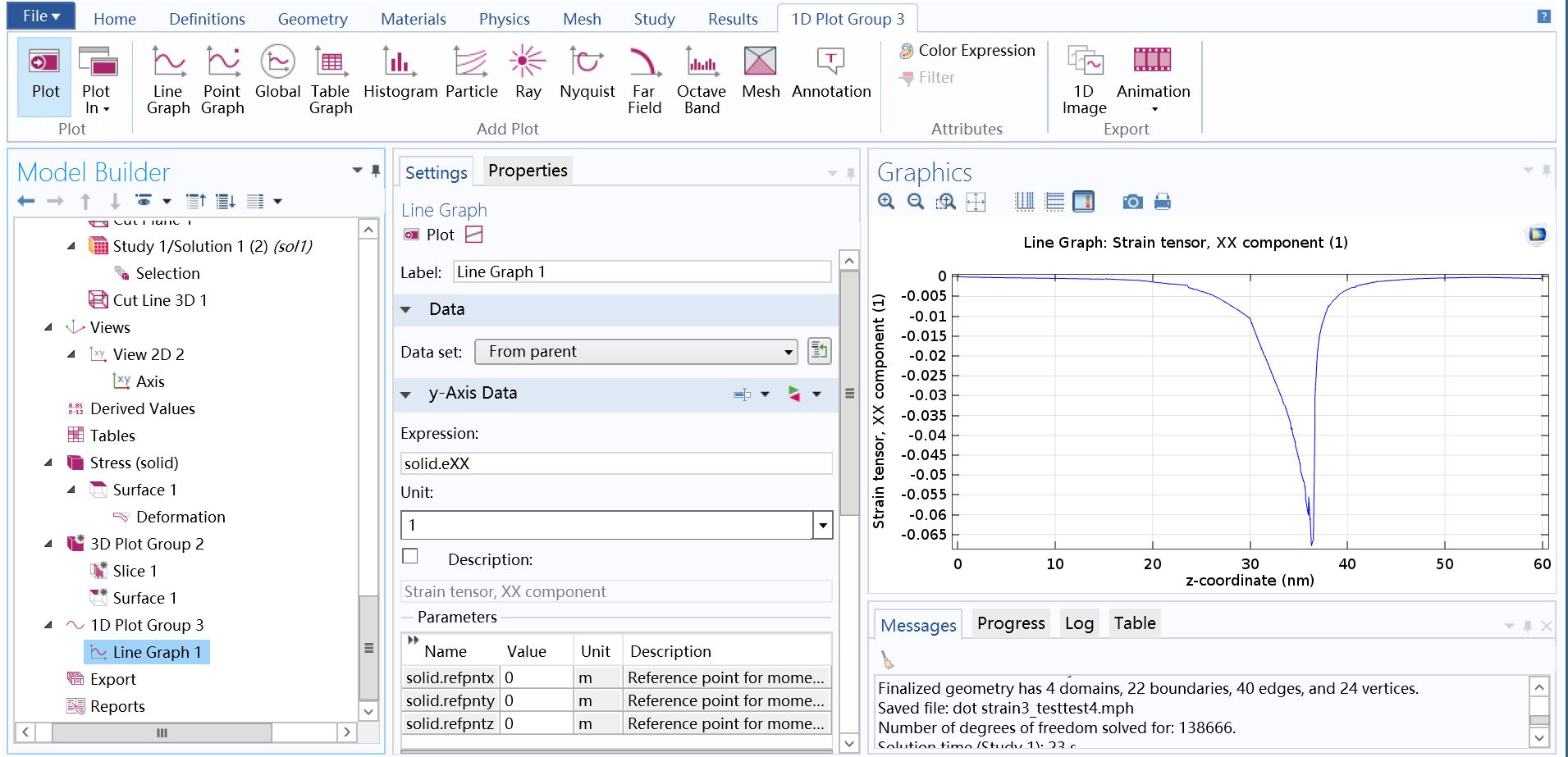

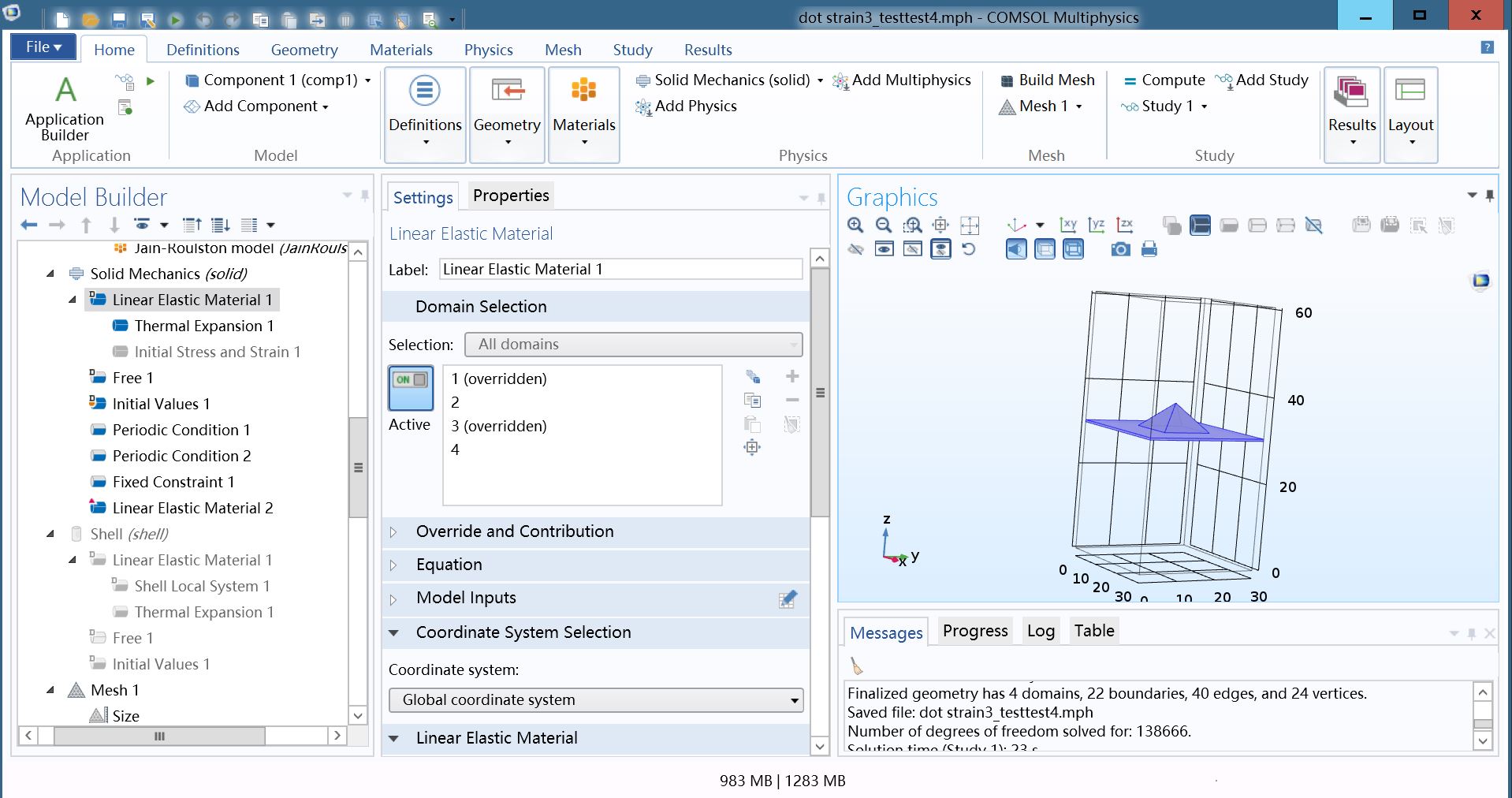

The pictures attached below are my model and strain tensor XX in z direction, but this result is diffenent to the paper. Could anyone give me some suggestion?
