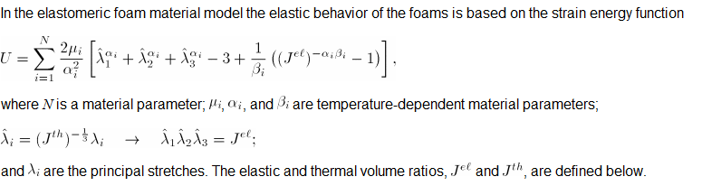

Hi. I have a similar problem.
I'm modelling a material with a foam type of behavior and would need a material model to characterize the compressibility.
The problem is that foam models are in terms of the principal stretches which seems to be a little hard to get a hold of in COMSOL.
Have anyone been able to implement a similar model and willing to share some tips i would be truly grateful.
Thank you!
Thank you!
The model shown in the attachment to this question is now (from version 4.3b) available as the 'Storakers' model.
Henrik
