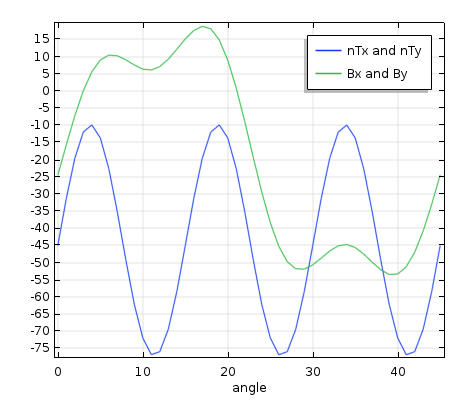

But, there is a difference between the two. The first attached figure tells it is.

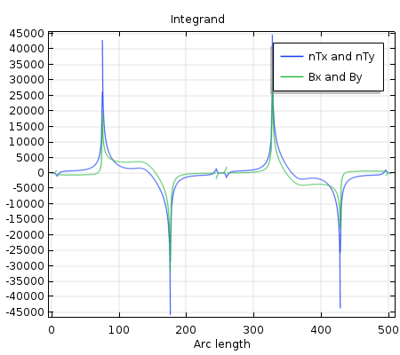

And after integrating them through the edges of the rotor the difference gets larger. In the second figure, blue line is the torque vs angle curve obtained by the "Force Calculation" node and green one by manual.
I've considered replacing with
( that is rmm.normB/rmm.normH ) but there was no big difference.
What is the reason of this difference? Does it just due to the numerical error? If it shows us significant difference to calculate torque with Maxwell's stress tensor, how does comsol do?
