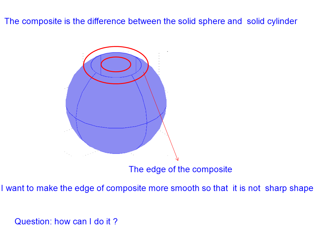

Hello:
I have a simple question about drawing the shape
step1: draw a sphere
step2:draw a cylinder
step3:select all
step4; choose " difference"
but I want to make the edge of composite more smooth so that it is not sharp shape
more details in the attachment
Thank you for your help

you have no fillet options in 3D within COMSOL (you need to use an external CAD programme then. But you can do , in COMSOL, define a workplane, draw a circle, a cut line or a rectangle then make the difference and finally fillet the sharp edge. Then you perform a revolve to get the 3D shape. Have a try
Hi you have no fillet options in 3D within COMSOL (you need to use an external CAD programme then. But you can do , in COMSOL, define a workplane, draw a circle, a cut line or a rectangle then make the difference and finally fillet the sharp edge. Then you perform a revolve to get the 3D shape. Have a try -- Good luck Ivar
Posted: 9 years ago 04.12.2015, 10:10 GMT-5
Update on this thread: Nowadays COMSOL does include a direct 3D filleting capability in the Design Module. See www.comsol.com/design-module
Update on this thread: Nowadays COMSOL does include a direct 3D filleting capability in the Design Module. See www.comsol.com/design-module Best, Jeff
