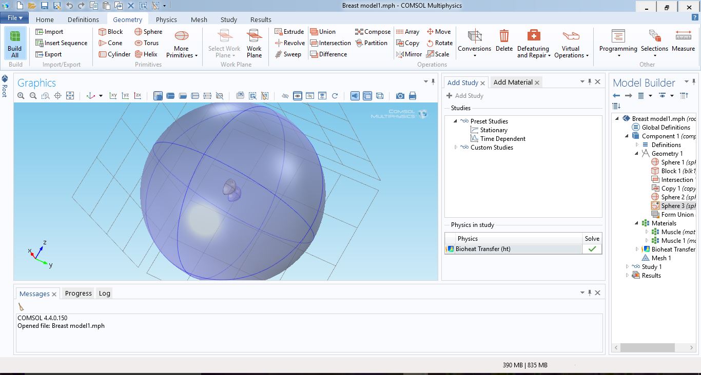

I am new to COMSOL. While working on my model, I did something that I don't know now and as a result, my geometry settings window is not available anymore. Tell me how to make my COMSOL interface (the window that opens when we open COMSOL working environment for the very first time) becomes same as it was when I installed it. I am attaching the picture of my COMSOL with this email. In this picture, I have drawn a sphere but I can't set its size, center etc. the window that does these things is hidden. Please help me solve this issue.

On the home toolbar you will find "Reset Desktop" that will bring the layout back to "normal".
