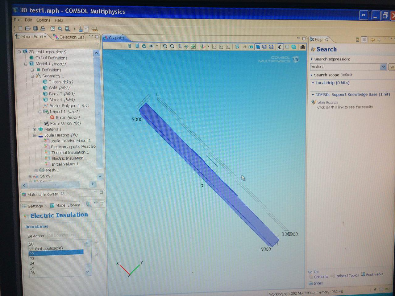

Posted: 8 years ago 17.08.2017, 14:45 GMT-4
Yes, sure. It is attached.
Boundaries are shown in the left bottom corner but I can't define them.
Yes, sure. It is attached. Boundaries are shown in the left bottom corner but I can't define them.
Posted: 8 years ago 17.08.2017, 14:52 GMT-4
That's not version 3.5a. It's some flavor of version 4.
The GUI changed thoroughly at version 4.0, so you won't be able to follow instructions written for 3.5a with this 4.x installation.
That's not version 3.5a. It's some flavor of version 4. The GUI changed thoroughly at version 4.0, so you won't be able to follow instructions written for 3.5a with this 4.x installation. Best, Jeff
