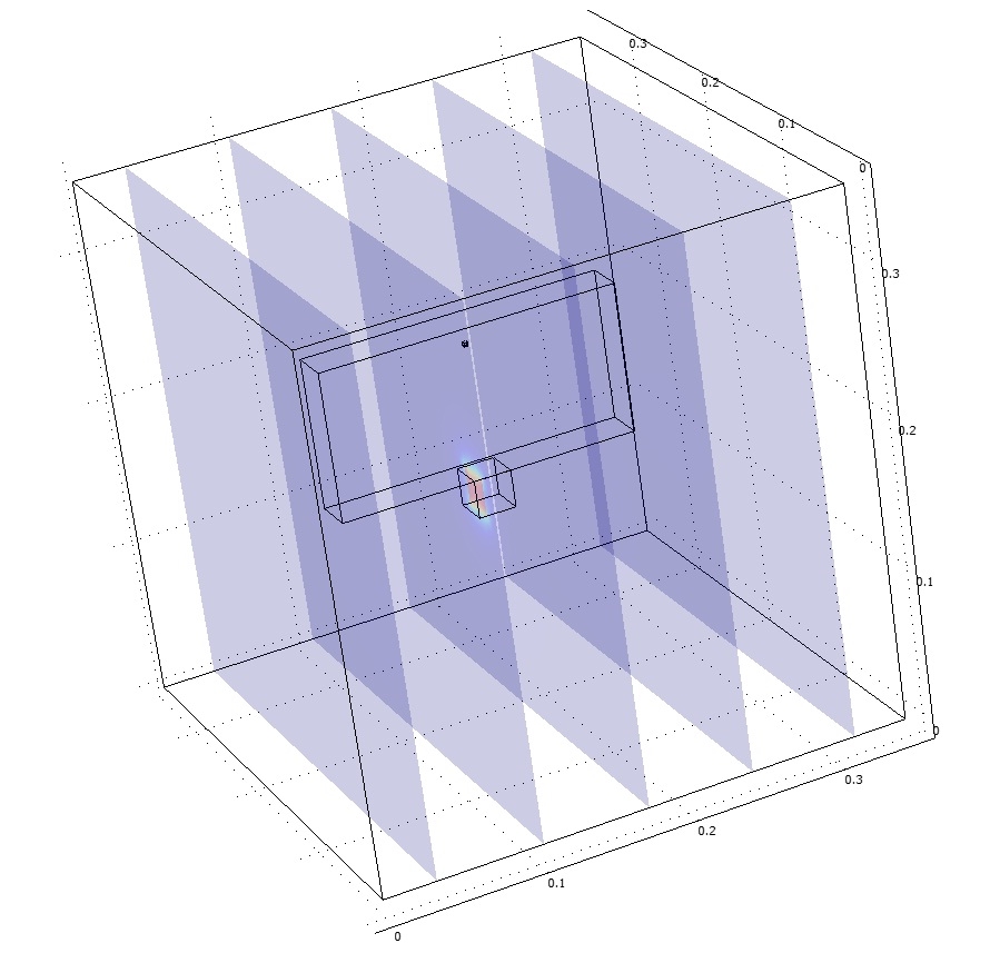

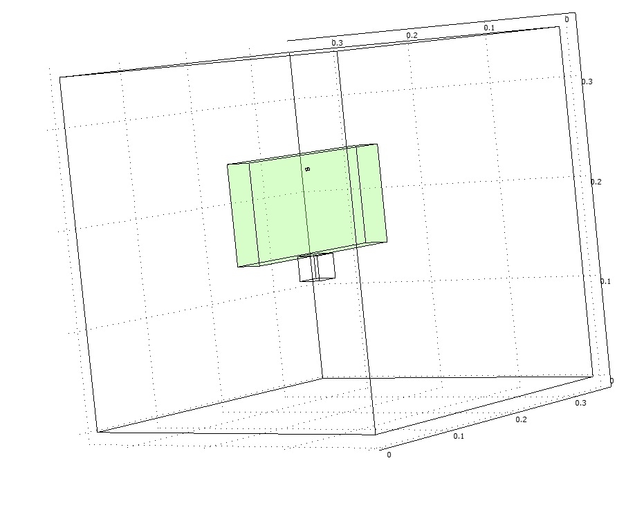

I am working on the design of a 3D Comsol model which mimics the setup of a 7cm x 10 cm dish filled with porous medium and nanoparticles located at the top of the dish which are then dragged down by a magnet of 0.8 T. The equations I used to design the model are the Magnetostatics (emqa), Convection and Diffusion (cd) and Brinkman Equations (chns). The model runs with the Magnetostatics and Convection and Diffusion equations, however, the Brinkman equations return the following error:

PS: I attached two images illustrating the model setup and the magnetic flux density slide plots after solving for the Magnetostatics eqautions.
