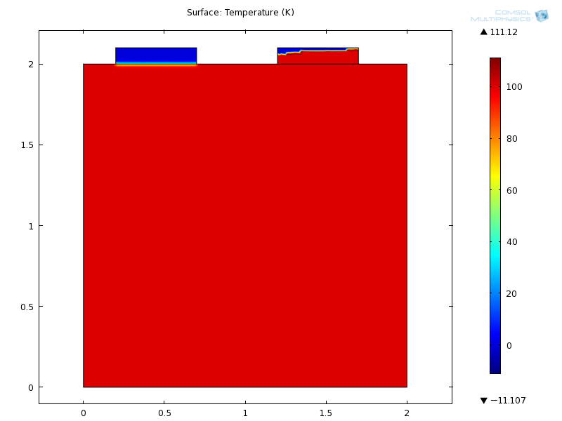

I have looked further into it, and the problem isn't really that the new feature behaves differently, actually.
It may perhaps by initialiased at zero, but even before the solver starts, the temperature is different. Looking like the attached image.
It seems COMSOL does some strange interpolation before it starts solving. Any idea what happens? It would help me a lot!
Thanks!
Peter
PS: The temperature of the square and left rectangle are from a previous simulation and the right rectangle on top of the square is added (which should be uniformly 0 K).

well first of all a temperature of -11K isn't really physical, OK its a shift of scale to get positive, I hope that the math representation of the physics behind COMSOL thermal does not limit to T>0 someway
Again it looks strange, not sure what to say. You can alsways send your model to Support and have them look into it ;)
Of course -11 K is physically not achievable (i want 0 K) ;) but I just used zero K as a reference temperature.
