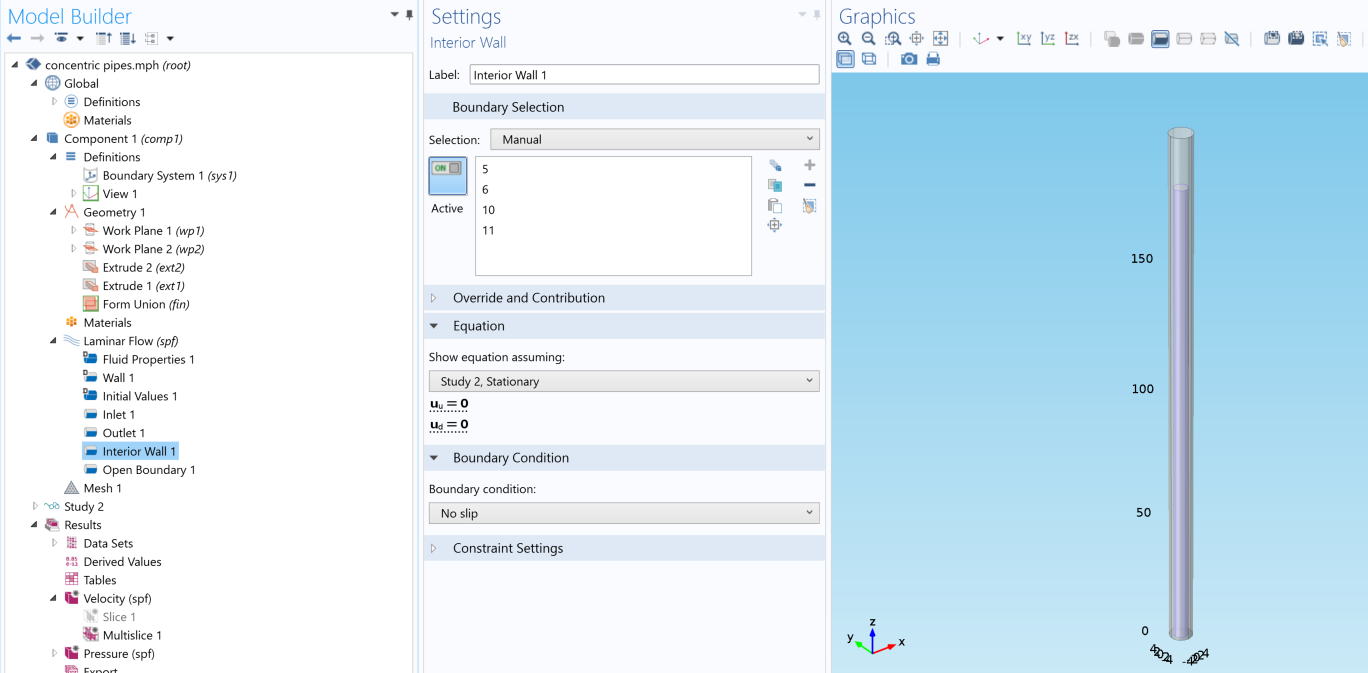

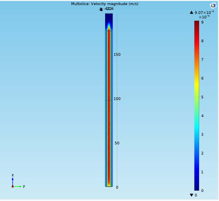

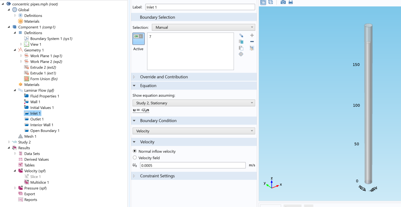

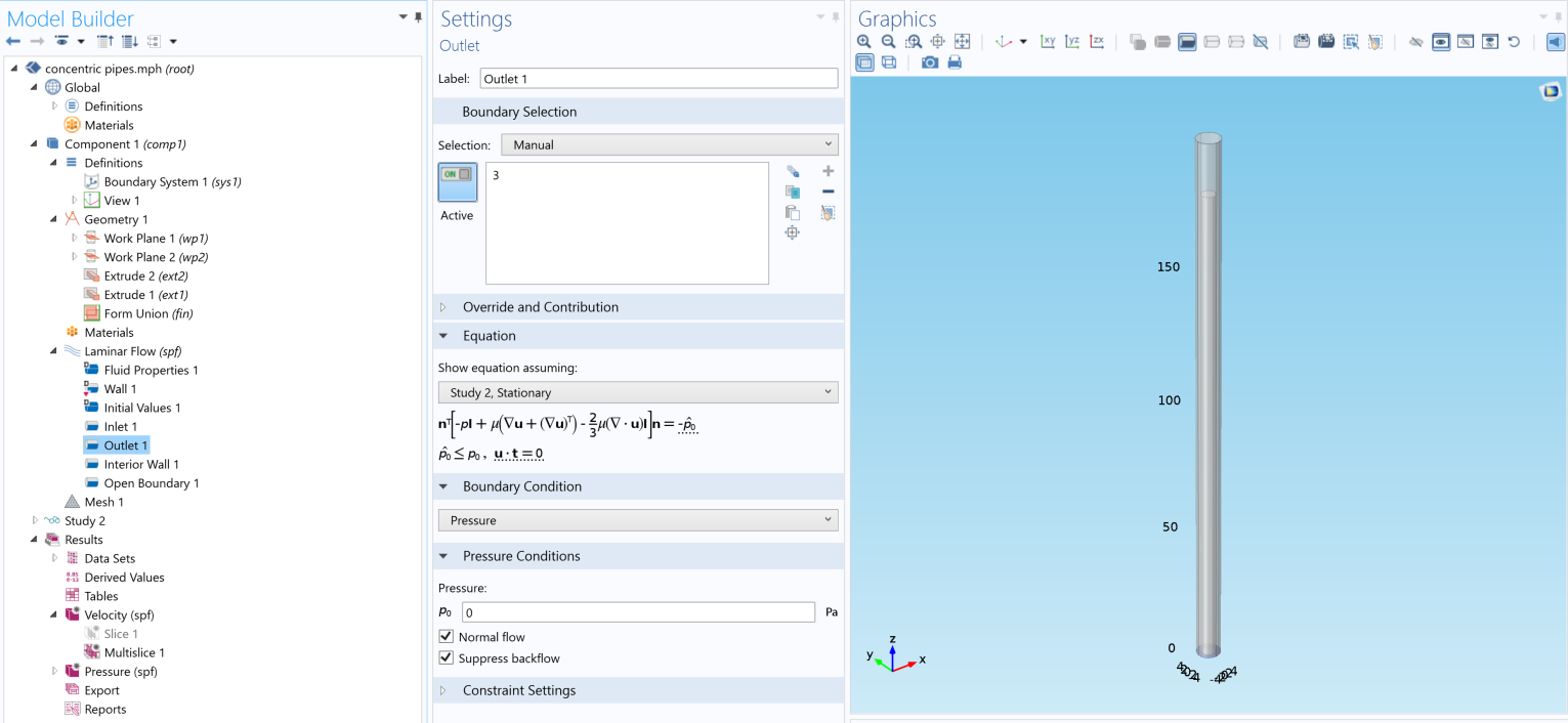

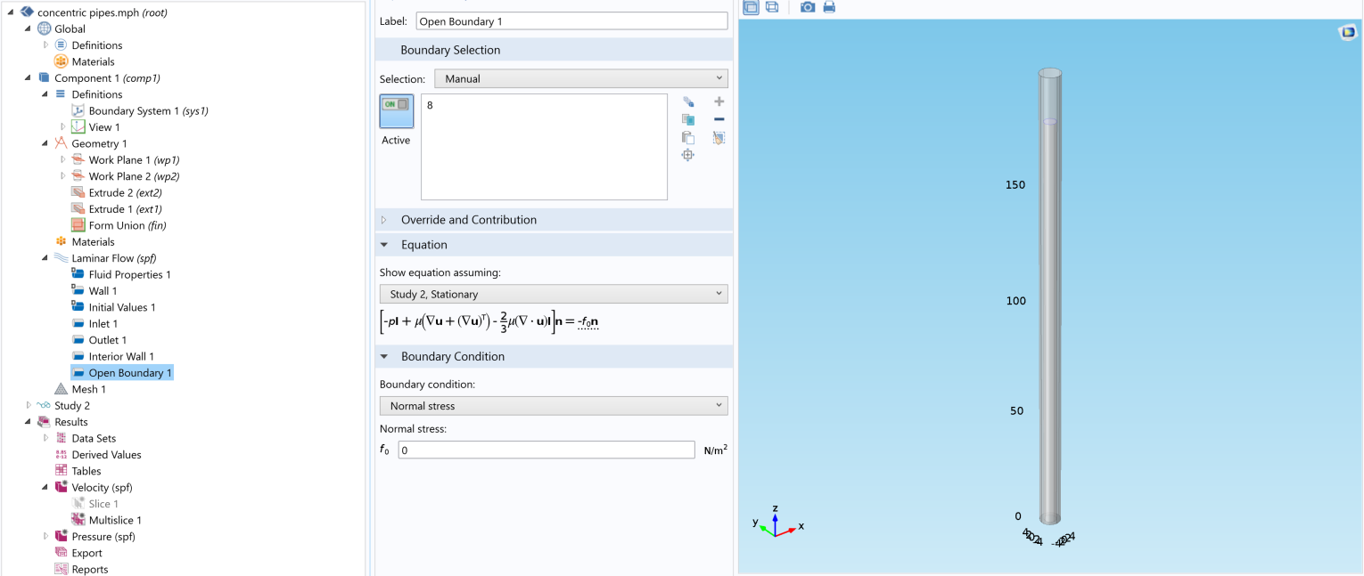

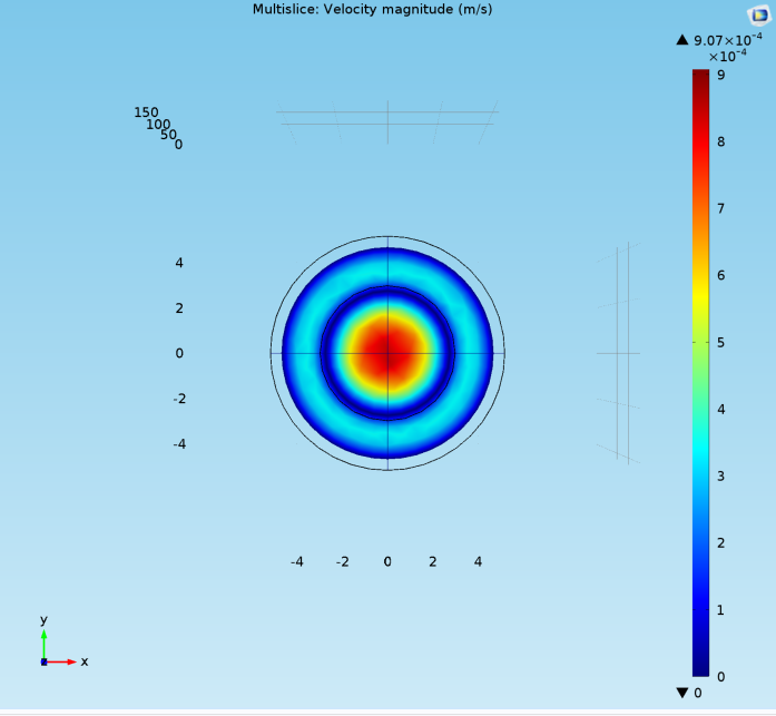

I am trying to simulate fluid flow through two concentric pipes. My model runs properly for low velocities (0.0005 M/S) but not higher once (0.5m/s). Attached are some pictures of the model. Please assist me.
