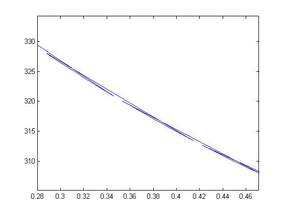

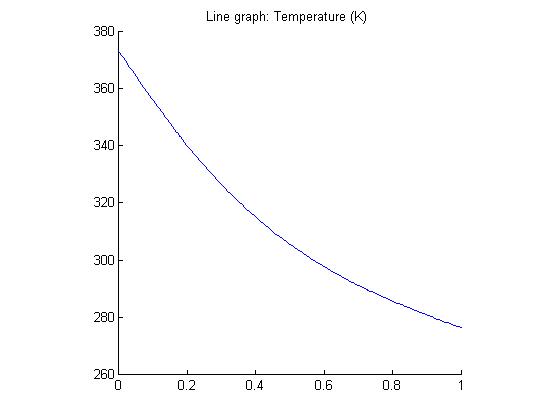

Well, I went through the test problem presented in the Livelink users guide. I loaded "heat_convection_2d.mph" from model library. I set up cut line (0.2, 0) - (0.2,1) [Plot Group2 in my case] and exported data along it to Matlab:
model = ModelUtil.model('heat2D');
figure(1)
mphplot(model,'pg2','rangenum',1)
[y,T] = mphinterp(model,{'y','T'},'dataset','cln1');
iy=~isnan(y);
iT=~isnan(T);
y=y(iy); T=T(iT);
figure(2)
plot(y,T);
But Data plotted with Matlab does not match what I've plotted with Comsol (see attached closeup graphs).
Any idea why?
Thanks in advance
