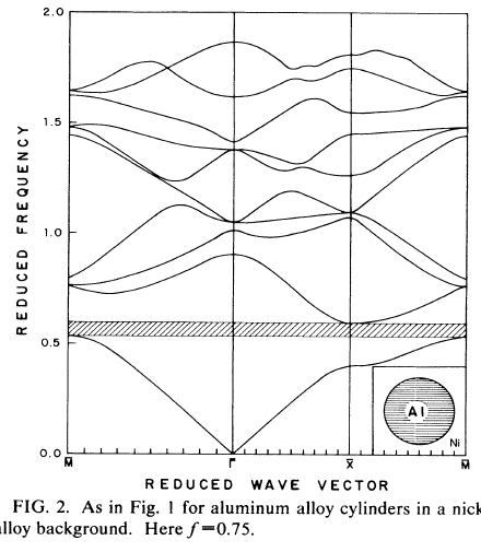

I am attempting to create the band structure plots for a square lattice of circular cylinders in 2d. Essentially these plots consist of listing the degenerate eigan solutions for the first brillouin zone i.e., the reciprocal lattice. My understanding is that people create these plots by sampling a continuum of wave vectors (or altering the direction of the incident plane waves) and plotting these wave vectors against freq.
My question is this: I am using Comsol to solve Helmholtz's equation for the all of the eigan frequency solutions of the reciprocal unit cell of my lattice near the location of the principle stop band. It then returns a bunch of frequencies, some with only one degenerate and others with more. This is fantastic and all but how do I extract the wave vector direction from these solutions to assign an x-axis position to the band structure plot given that the eigan value approach uses no source terms?
see attached plot for example of what I want to create
I am using periodic boundary conditions see attached sim file
I am attempting to create the band structure plots for a square lattice of circular cylinders in 2d. Essentially these plots consist of listing the degenerate eigan solutions for the first brillouin zone i.e., the reciprocal lattice. My understanding is that people create these plots by sampling a continuum of wave vectors (or altering the direction of the incident plane waves) and plotting these wave vectors against freq. My question is this: I am using Comsol to solve Helmholtz's equation for the all of the eigan frequency solutions of the reciprocal unit cell of my lattice near the location of the principle stop band. It then returns a bunch of frequencies, some with only one degenerate and others with more. This is fantastic and all but how do I extract the wave vector direction from these solutions to assign an x-axis position to the band structure plot given that the eigan value approach uses no source terms? see attached plot for example of what I want to create I am using periodic boundary conditions see attached sim file
