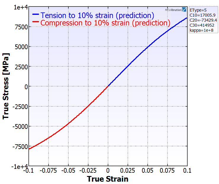

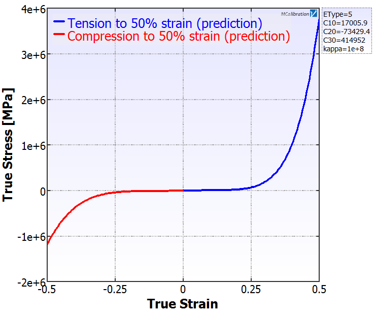

Posted: 8 years ago 16.03.2017, 14:36 GMT-4
Here are figures showing the stress-strain behavior up to 10% logarithmic/true strain and up to 50% logarithmic/true strain.
