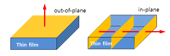

hi i'm new in comsol. I make 2D thin film to simulation.
there are 2D approximation in structural mechanics. so i'll use plane stress condition.
in comsol document and forum, z-direction is out-of-plane direction so stress of z direction is zero.
but in my model, i make y direction to out-of-plane direction.
in my model is cross-section view of xz-plane in attatched file.
what i wonder is plane stress condition make z-direction only out-of-plane direction.
i change thickness to know where is out-of-plane direction. but i don't know where it is.
Thanks

It sounds like you have already found the answer to your question: in COMSOL, a plane stress study is conducted in the xy plane. The out of plane direction, z, corresponds to the thickness.
Hello DoWon, It sounds like you have already found the answer to your question: in COMSOL, a plane stress study is conducted in the xy plane. The out of plane direction, z, corresponds to the thickness. Best regards, Jeff

thanks for your answer.
in comsol document, plane stress condition has no stress of out-of-plane direction(z-direction).
and thickness of z-direction is very thin.
but my model has very thin thickness of y-direction. so i think z
in plane stress condition, the length of specific direction is not considered?
thanks for your answer. in comsol document, plane stress condition has no stress of out-of-plane direction(z-direction). and thickness of z-direction is very thin. but my model has very thin thickness of y-direction. so i think z in plane stress condition, the length of specific direction is not considered?
