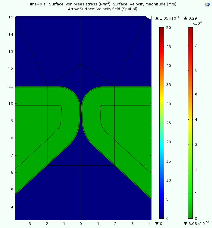

I use (fsi) module for modelling of vocal fold vibrations in 2D. At certain conditions the solid (vocal fold) deforms the fluid mesh too much resulting in mesh collapsing / degradation.
How could I prevent fluid mesh from collapsing/degradation?
Is it possible to define an offset or to limit the displacement of the solid when it reaches a certain value?

I've attached a picture (gif-animation; there are very first time steps of the simulation when the vocal folds abduct and phonation begins) so it would be more clear what I'm working on.
My first idea was to solve the problem by using "contact functionality".
Unfortunately, contact and fluid - structure - interaction conditions can not be assigned to the same boundary simultaniously (I tried it out).
Presently I would like to handle degradation of the mesh during adduction of the vocal folds by introducing of an offset in comination with a nonlinear boundary load acting like a spring.
