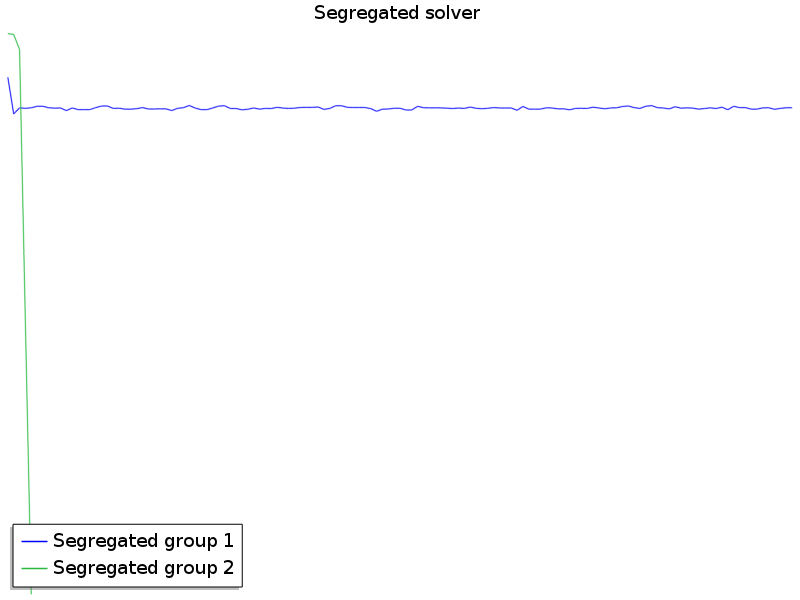

I followed your advice and set the contact offset. The radius of adjacent sphere is R, the initial gap between them is set to a=0.01*R, then "form union" is used to assemble geometry. In Structural mechanics module, both destination contact offset and source contact offset are set to 0.01*a. I think it's really small compared to the radius of sphere. But when I run only structural mechanics, It still didn't converge. In segregation solver plot, contact pressure converge well, otherwise displacement suspend at 10^-2 a long iteration.
I didn't figure out the problem of this divergence. Is the value of contact offset reasonable in my setting?

Posted: 9 years ago 21.09.2016, 17:45 GMT-4
I posted the error plot in the attachment. Does anyone give any advice about it?
