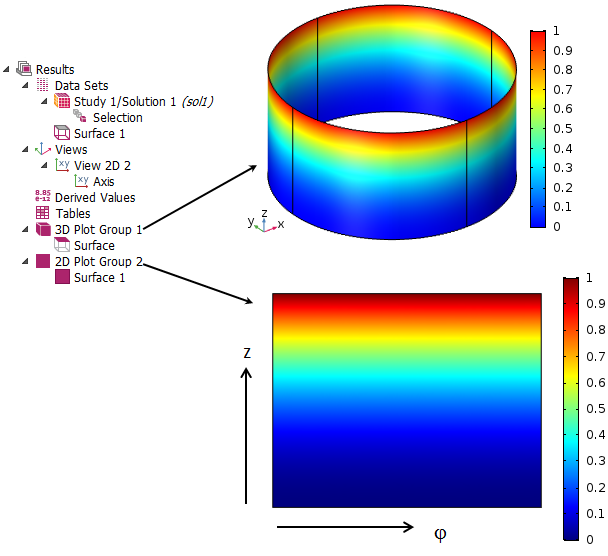

Ben,
Steps to plot flat cylinder are shown in the attached png and mph files.
Sergei
