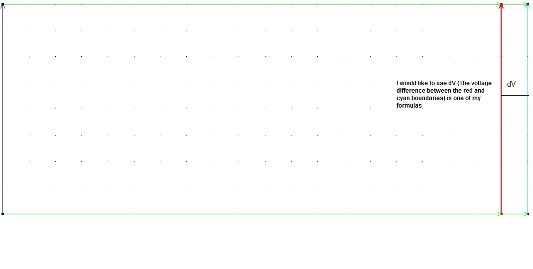

Hi Ivar,
My name is Omer and I'm Halil's partner.
First of all, thank you for your quick answer.
We used your solution for perfect conductors by using Integration Coupling Variables. but now we need to make a more realistic model and for that we need option 2 - not a prefect conductor. so now we need to calculate the potential difference for each point. Can you please elaborate about the mapping operator?
Thank you very much,
Halil and Omer

Ivar KJELBERG
Posted:
1 decade ago
22.12.2010, 21:08 MEZ
you need then to define first how you define the two corresponding points, one on each surface, to then get a voltage by difference, it could be by a normal prjection or by another mean.
Now your non-perfect surface might still be sufficient to provide a rather uniform voltage value so the projection definition might not be that wrong
