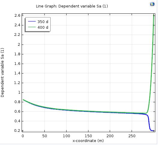

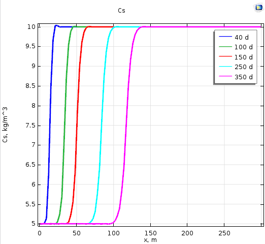

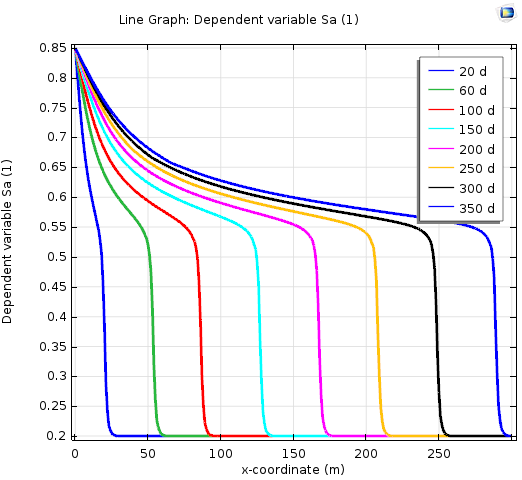

Here, I attach two images of the aqueous phase saturation (Sa). From the graphs, after 350d, Sa will exceed 1, which is not consistant with the changing law of saturation. While Cs (concentration of salt) comlpies with the paper.
