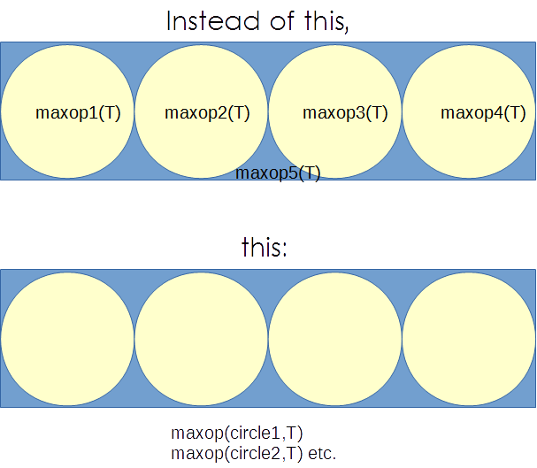

- I have an assembly consisting of an array of circles in a rectangular matrix (please see picture).
- I have a Heat Transfer Physics and I need to define a global ODE. The ODE should read the maximum temperature of a single domain (whether circles or rectangle)
- I would like to set a maximum operator for the entire assembly (including the circles and the rectangle domains)
- In the ODE, I would like to read the maximum temperature of a single domain, but using the maximum operator for the entire assembly.
- It is possible to "split" the maximum operator in different domains? Something like maxop(circle1.T), maxop(circle2.T), maxop(rectangle,T) etc., maxop being the overall operator.
That is, I would like to have the option to read the maximum temperature on each domain, without the need of creating multiple operators?

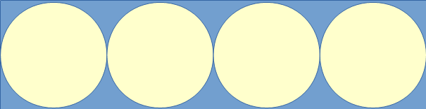

I have added another picture to describe my question. I hope this helps!
