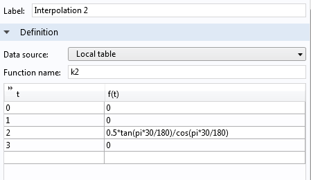

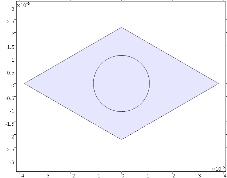

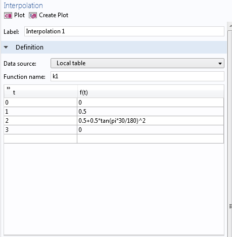

I'm trying to expand the photonic bandgap model (www.comsol.com/model/bandgap-analysis-of-a-photonic-crystal-798) to a slightly different structure, but since I'm new to photonic crystals, I'm struggling with this.
In the model, a square lattice is simulated, with lattice constants a1, a2 = a. The primitive cell is a square with the circular column in the centre. I want to simulate a triangular lattice. The cell changes into a parallelogram, and
kk1*(k1*b1x+k2*b2x)
kk2*(k1*b1y+k2*b2y)
Where b1, b2 are reciprocal lattice vectors and kk1/k1/k2 are my parameters. For the initial eigenfrequency sweep at Gamma I set:
kk1=kk2=k1=k2=0
For the subsequent sweep kk2=1 and I'm sweeping k1=0...1.
Now, to get from M
Failed to find a solution for the initial parameter.
Maximum number of Newton iterations reached.
There was an error message from the linear solver.
The relative error (1.7e+003) is greater than the relative tolerance.
Where might this be coming from? There must be a difference between starting at k=0 and k!=0 that I'm missing.
