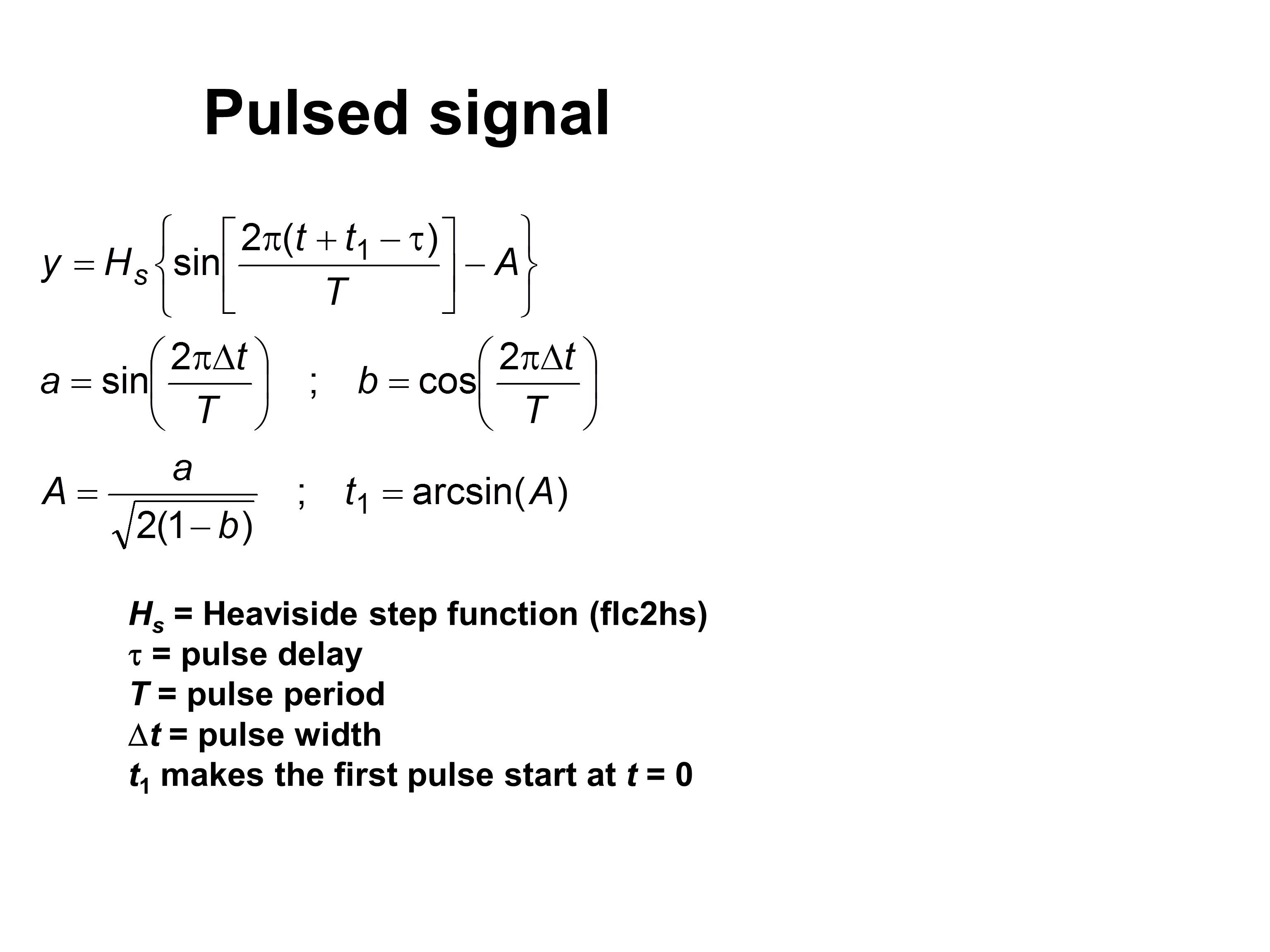

I made this calculations once, when I needed a pulsed boundary condition with an arbitrary pulse duty cycle. I cannot recall any more, how I did it but, please, here you have it attached. It works, I can guarantee :)
Lasse
I made this calculations once, when I needed a pulsed boundary condition with an arbitrary pulse duty cycle. I cannot recall any more, how I did it but, please, here you have it attached. It works, I can guarantee :) Lasse

But if you just need a square wave signal use
y = sign(sin(2pi*t/T))
where T is the pulse period. It is easy to modify this according to your needs.
Lasse
But if you just need a square wave signal use y = sign(sin(2pi*t/T)) where T is the pulse period. It is easy to modify this according to your needs. Lasse

Thanks a lot Lasse, it worked for me very well!
