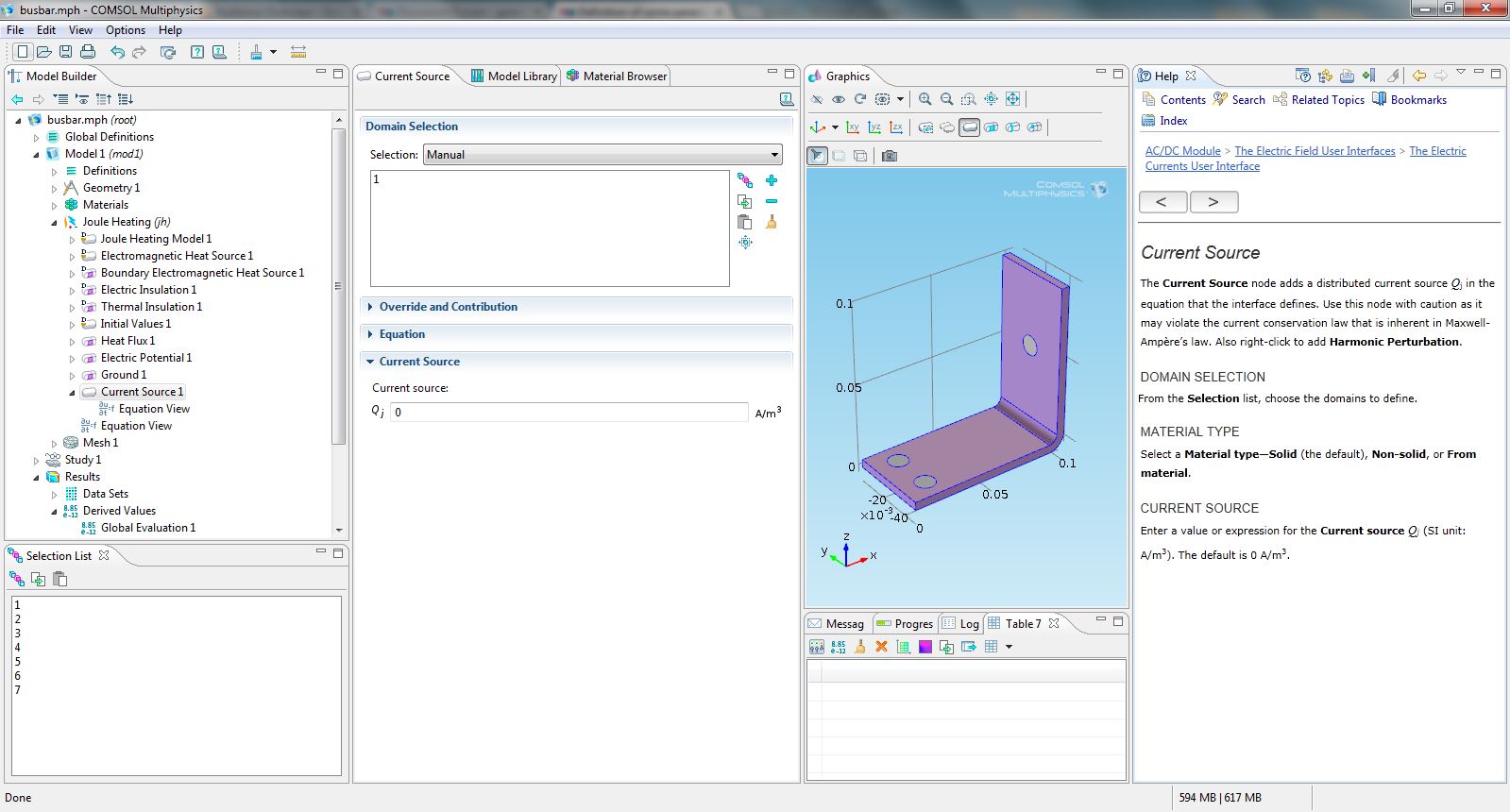

1. Qj is a distributed current source, see the screenshot with a definition.

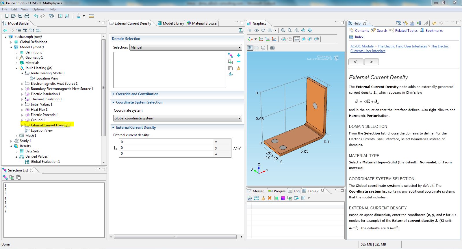

2. Je is an external current density, see the screenshot with a definition.

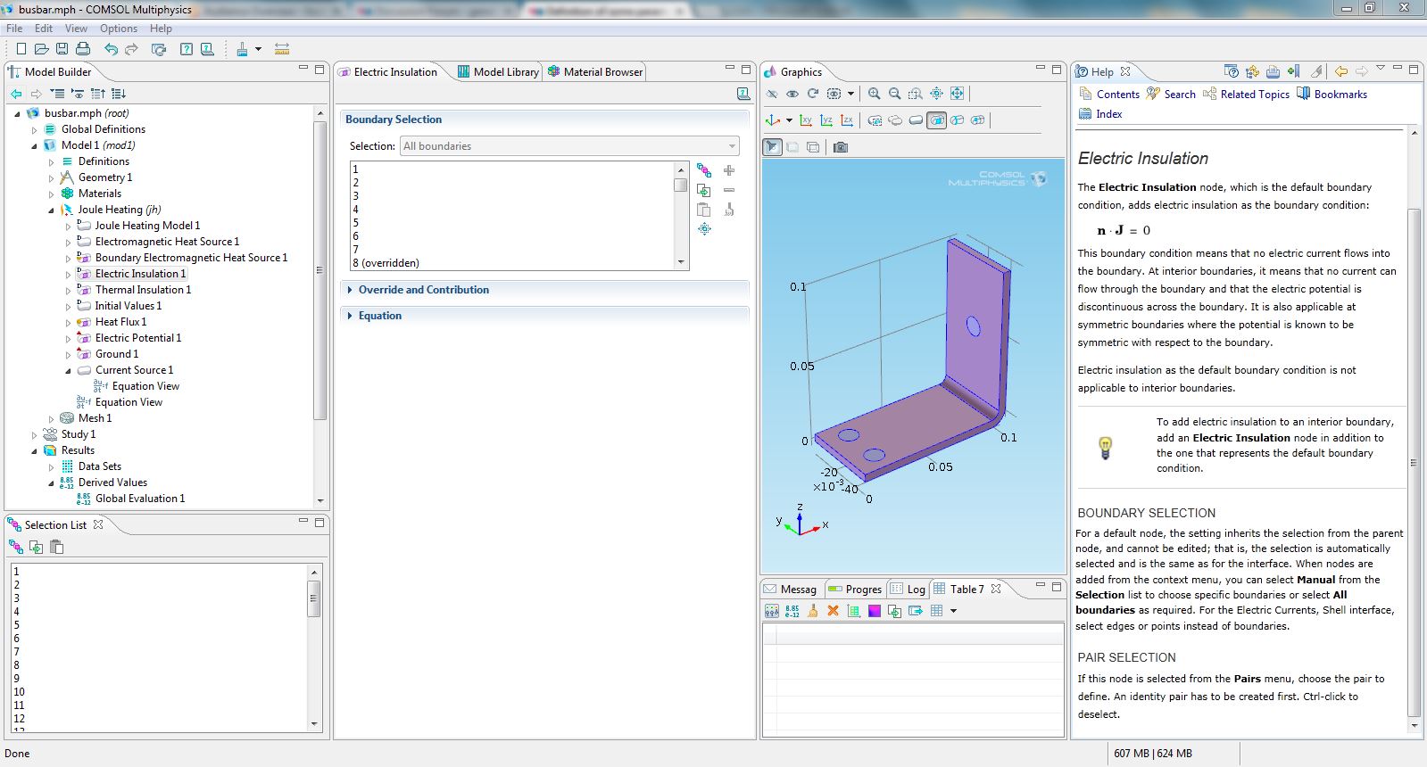

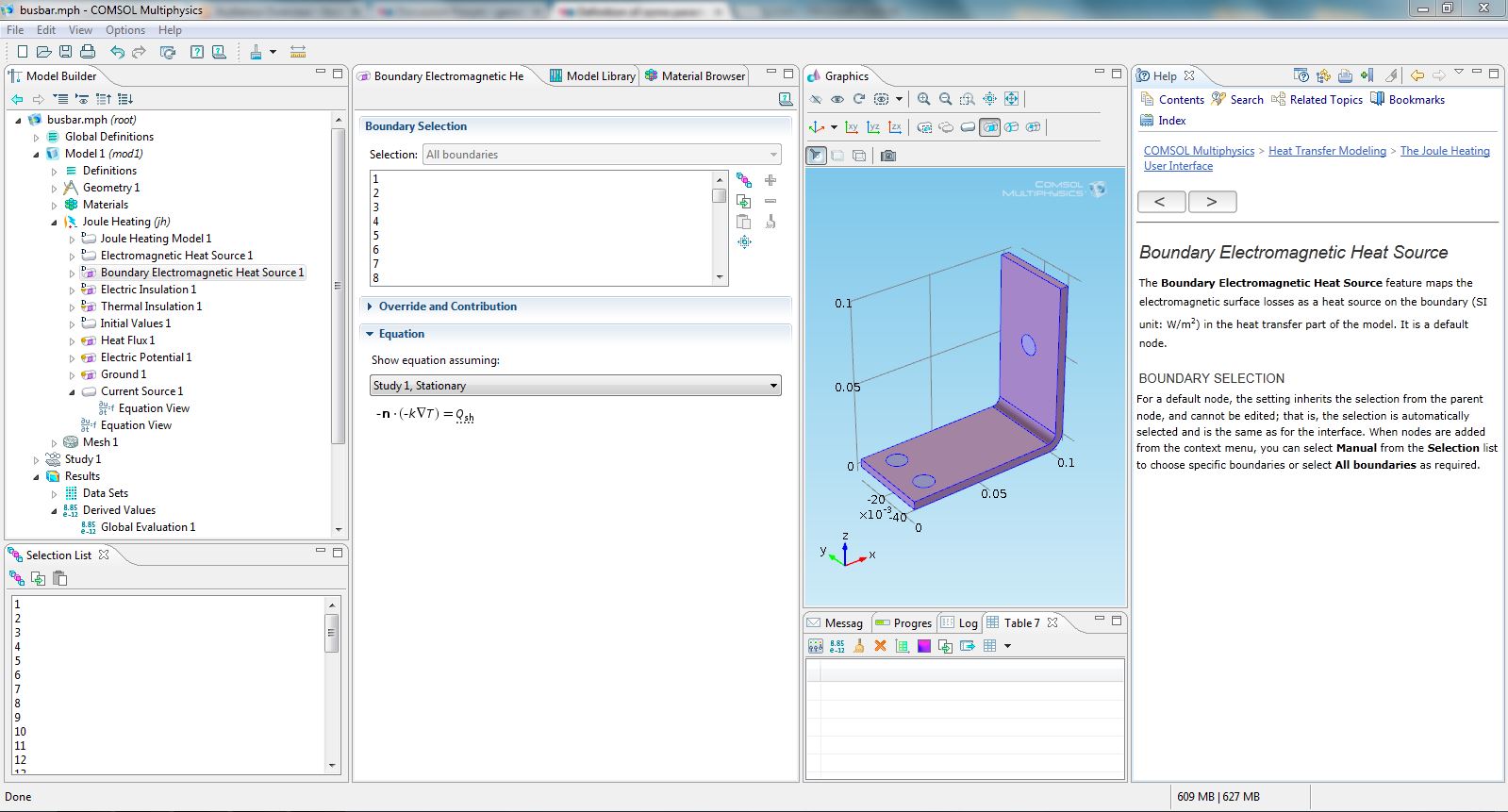

4. Compare the definitions of "boundary electromagnetic heat source" and "electric insulation" in the attached screenshots.
